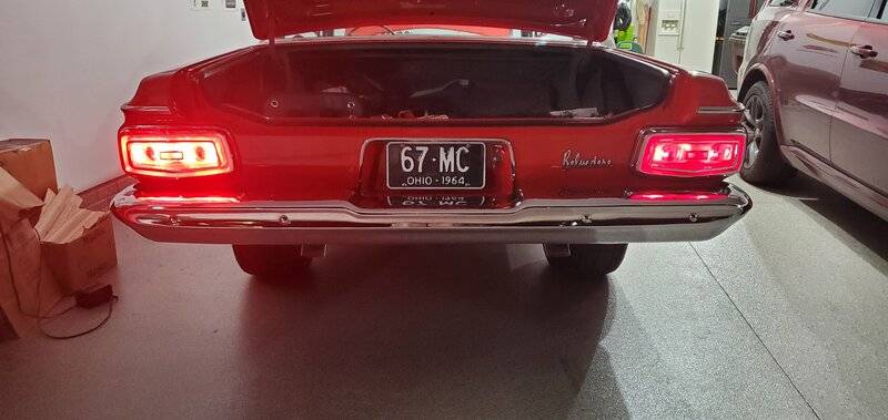

I have a 64 Belvedere and I want to upgrade to LED bulbs. I have the GTR Lighting Carbide 2.0 from Headlight Revolutions in the tail light and they're amazing. The attached picture is of both sides on marker light, incredibly bright on brake lights.... anyway, I tried to install the same bulbs in the front marker/turn signal light and they do not work.... they do come on with the parking lights on (very dimly) but no flashing. In fact the tail lights won't flash either. I'm thinking it has something to do with the fact that these cars are set up to shut off the parking lights when you pull the knob out to turn on the headlights. Has anyone tried this or found a work-around? I know that a 2357 incandescent bulb is slightly bright in turn signal mode but really would like to go all LED if possible. Thanks, Mike

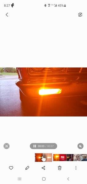

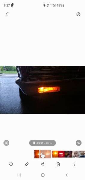

UPDATED.... I ordered the CEC 32RLNP flasher with external ground and it fixed the problem. The pictures don't do it justice. Just on parking light the LED is brighter than the incandescent bulb when it's blinking and when the LED is blinking... it's BRIGHT. Thanks to all who gave advice/info. If anyone wants part numbers let me know.
