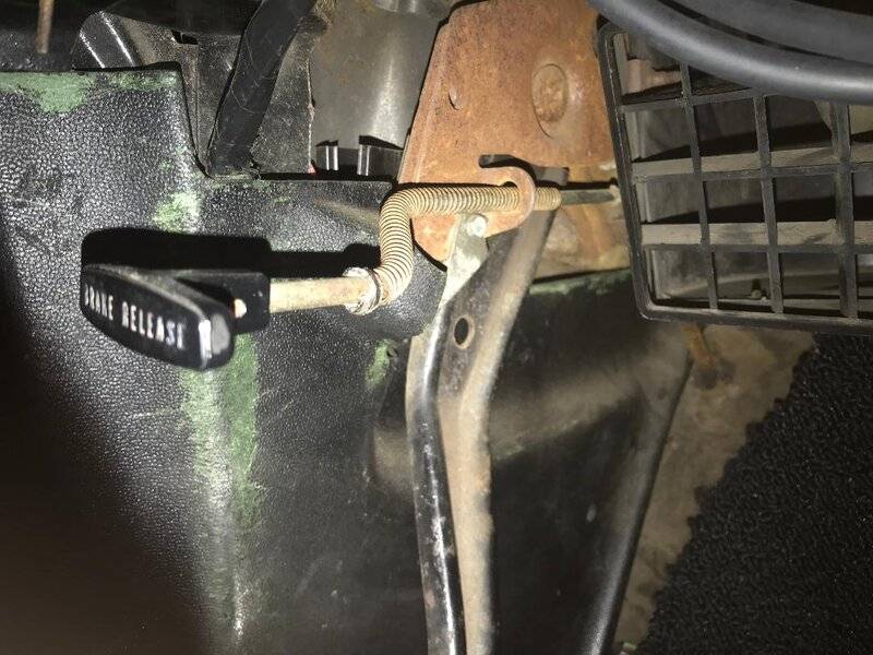

this is a common thing when these get old, how do you fix these parking break pedals when the nylon retainer wares out.

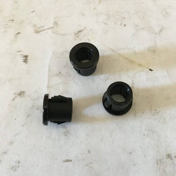

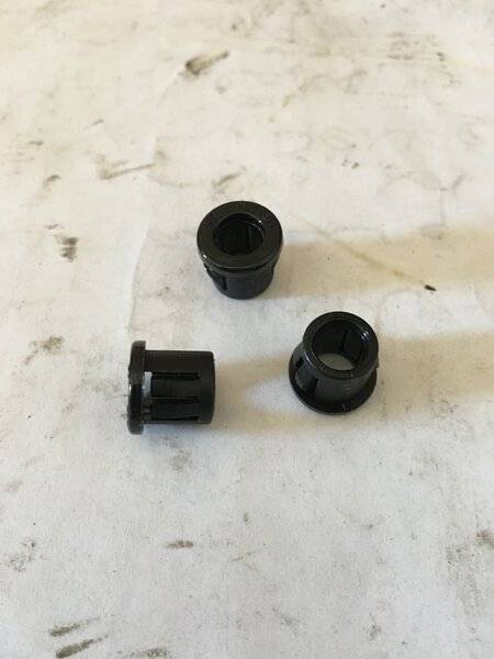

I have sleeves that fit pretty damn good !! I post pics later.

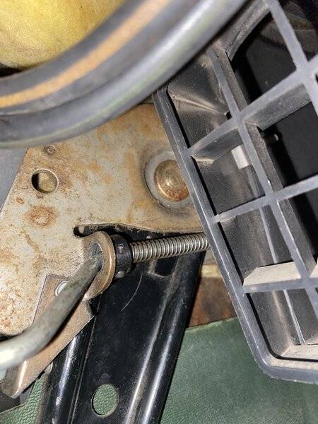

I used one of these between the spring and the handle bracket. Not OEM but it works great and is easy to install without removing the handle. I bought mine at Ace Hardware for around $5.
