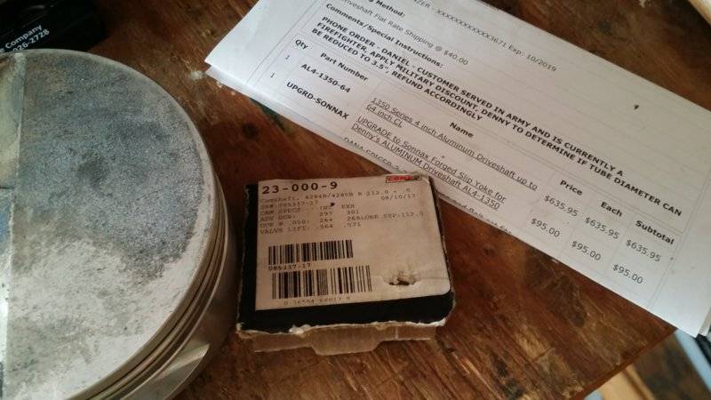

I couldn't afford the $8/gal 110 leaded gas on the street, so I had thr motor yanked and put to 93 octane specs. It's got a much smaller Comp Cam, I dropped the compression to 10.5:1, and I replaced the cracked crankshaft we discovered with a Scat crank. The top end remained an AED 1000 four barrel and Indy 572-13 heads and a single plane, solid roller lifters, and the displacement is now 580". It made 600rwhp, so roughly 700hp at the crank? Maybe 750.
