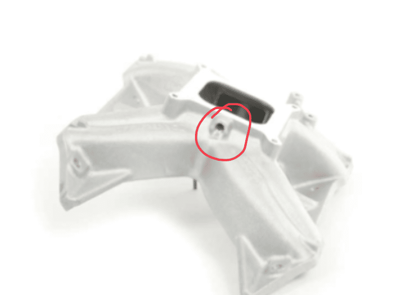

Was not sure to run a hose to throttle body base, or the intake somewhere if i can find a port on this Edelbroch Torker 440
There is one intake on the Torker. Base of carburetor firewall side.

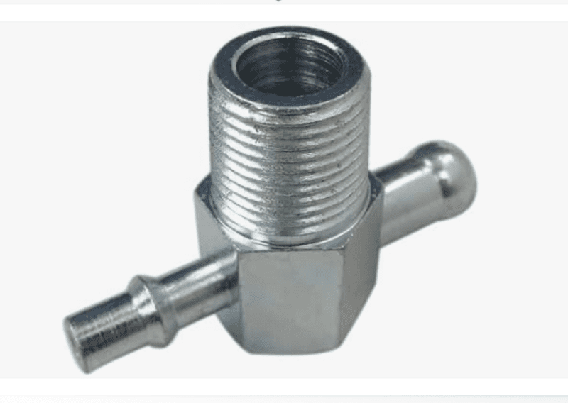

Are you speaking of these?

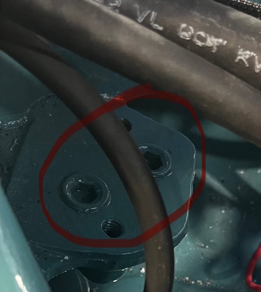

I believe there’s a plug on the throttle body front base….
You have efi correct? Yes usually there are some plugged ports in the base
There are some front and rear, but i get conflicting answers…. Use carb vacuum, use manifold vacuum….
