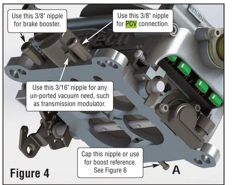

You will need to refer to your EFI instructions, my Fitech installation manual (see photo) suggested using one port vs another for PCV vs Brake Booster but the takeaway I had was that the carb base spreads the oil residue across all cylinders and should be used over a port in the intake that feeds vapor to only 1 or 2 of the cylinders. Ultimately you will need to look at the specific parts you have to determine how they are configured.
Both my FiTech EFI and my Holley Sniper EFI have 3/8" hose connectors for PCV or brake booster use...PCV valve typically goes on one valve cover and a vented breather cap goes on the other. Fresh air is drawn into the crankcase of the engine through the vented breather and ends up in the intake manifold via the PCV valve and engine vacuum. A side benefit is that the top of the engine stays much cleaner.

Koosh, On street engine run with a pcv. Hook to 3/8 un Ported vacuum, front or back but below the blades.
You need a breather in the other valve cover for inbound air flow. This will help with internal pressure and help prevent oil leaks.

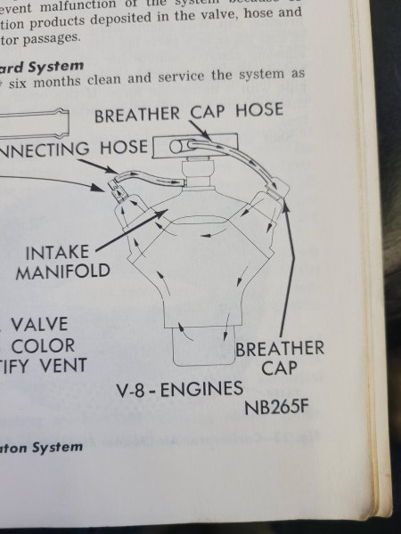

air normally gets sucked through a breather on one side and circulates across to the pcv on the other side; IE left front to right rear
sort of unrelated, but AMC's work front to back........ but same principal, they need to be apart from each other
when functioning properly, on a healthy engine with no blowby; you should be able to stick a dollar bill to the breather side hole (suction)
can you expand on this a bit more? What if it's a breather cap that has a PCV valve built-in installed on one valve cover? Any need to separate the 2?
