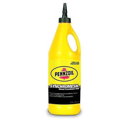

Does any use Pennzoil Synchromesh in their 4-Speed Transmission
Thanks Tom C.
I do, I also use it in my uncles 70’ RR and my buddy uses it in his Duster.
I had a slight gear clash from 1-2 when cold. I used the factory recommended SAE 140 and it was like molasses in January, gear clash in ALL gears. Went to Sta-Lube 85/90 from Napa and it was better. Talked to a local Mopar expert about replacing the synchros and he suggested trying the Penzoil Synchromesh first. Worked like a charm and saved me a lot of money. I give it a big :thumbsup:
I just put it in mine. Didnt notice and difference

I had a local Amzoil rep tell me to be careful when selecting from these newer lubricants. For instance, if your vehicle called for a 75w-90 GL-4, use Amzoil Manual Transmission and Transaxle Gear Lube, not AMSOIL Synthetic Manual Synchromesh Transmission Fluid, as it is too thin. Might check with Pennzoil to see if they recommend Synchromesh for older transmissions.
