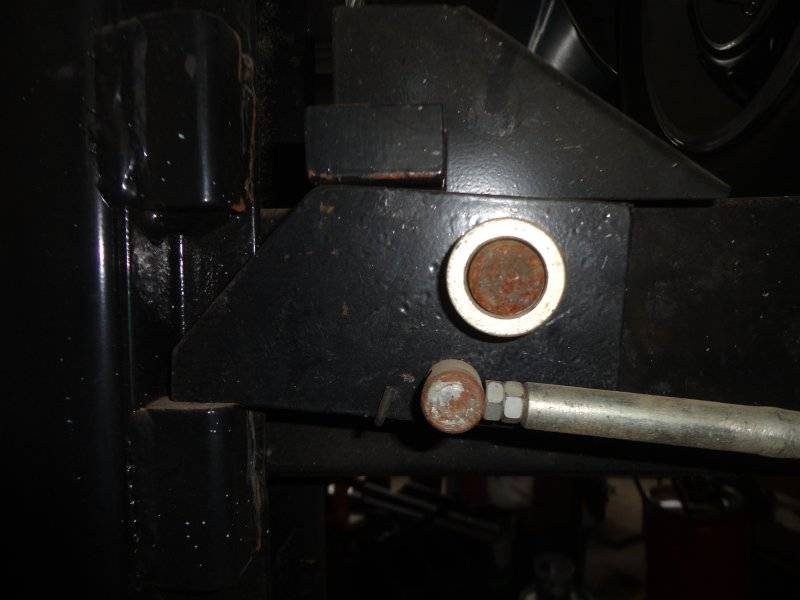

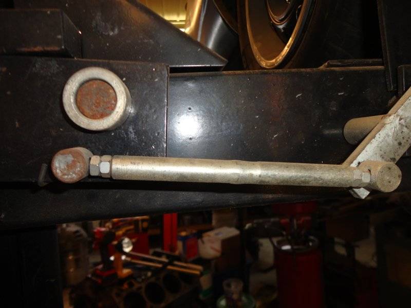

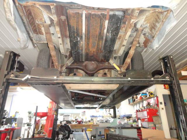

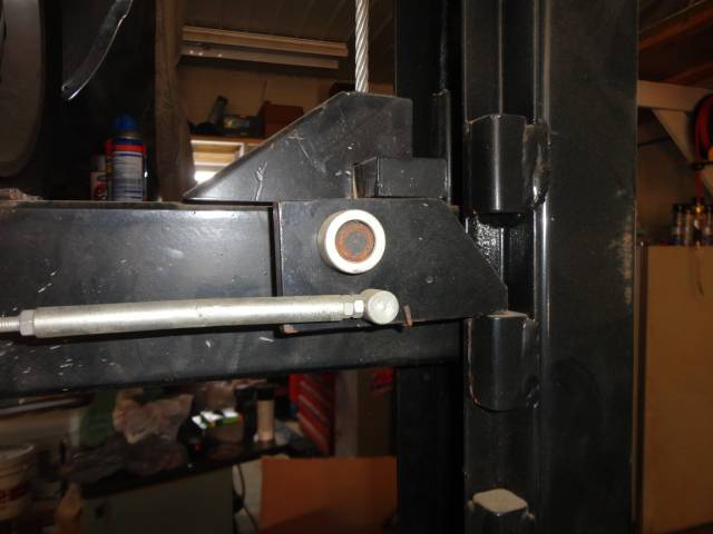

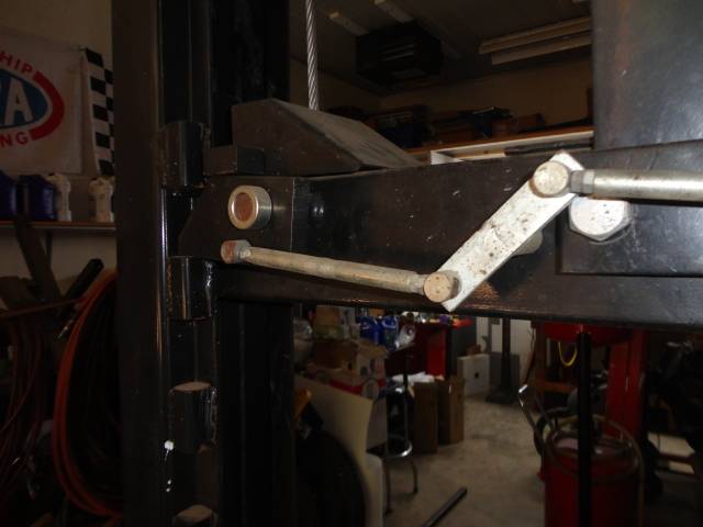

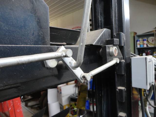

Here's the stop mechanism on mine. Pretty simple and has worked for 20yrs.
First 3 are the mechanism on back end as I call it. Opposite end from controls. The silver rod runs from side to side attached to the stops. There is a spring on each stop mechanism to keep it rotated up.
Front is same as back only has handle. The silver cross piece where the rods hook to runs from front to back inside the platform. Has handle attached in front
Thank you for the pics! That looks almost identical to my lift...locks, mechanisms, cover plates etc, what make and model is it? Mine had no tags or data plates on it, I was told it was a Lift King but since everything is odd ball metric I'm pretty sure it is not, plus I contacted lift king asking if they use metric hardware and they said no everything is standard SAE.
I'm not sure I think it's Atlas. It's a 7000lb lift. I bought it from Greg Smith Equipment 25 years ago. They sold all kinds of shop equipment. Got my bead blast cabinet from them too, and it still works after 20 yrs.
Greg Smith Equipment Lifts

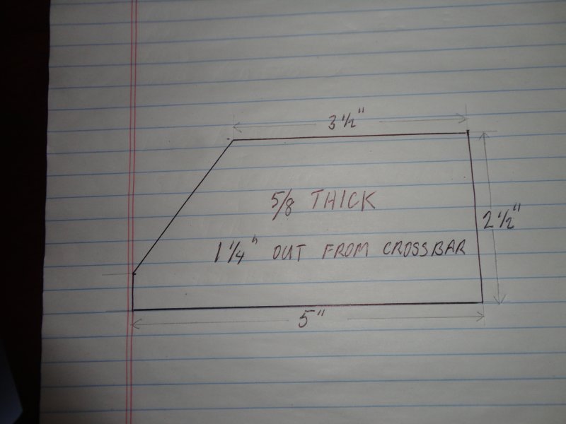

@GTXDAN, and others.....I'm working on getting my manual lock system built and was wondering if you would be willing to grab a few measurements for me off your lift.
Looking for the rough dimensions of the plate the linkage rods attach to, and how far out from the cross beam it sits. Also the basic center to center measurement on the short rod, that should get me in the ball park for building my system.
Very much appreciated.
Here is I hope what you are looking for. The actual lock plate at the post.
The left hand end is 1/2", forgot to write it down.
The short rod is 6 3/8" center to center.

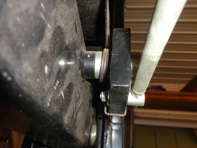

Thank you that is very helpful, but I am also looking for the measurements of the T fitting that both linkage rods attach to....on the far right side of this pic...
https://www.forbbodiesonly.com/moparforum/attachments/dsc01787-jpg.1544283/
The "T" fitting is 4" x 1" with the rods at 3" center to center with 1 1/2" space from cross beam.
