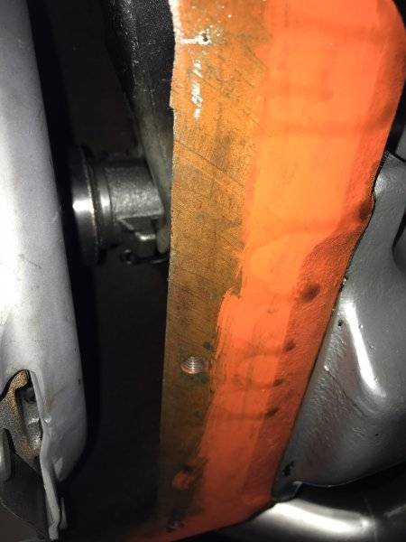

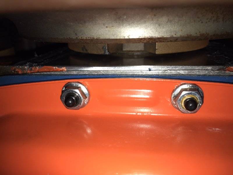

OK - This is not a major issue as in my motor is knocking, or blowing smoke, or won’t start but it is starting to irritate me. Last spring I replaced the rear seal, the oil pan and gaskets and the valve cover gaskets on my Hemi. I think it had a side seal leak on the rear seal retainer but also some drips coming down from above, some of which I got stopped. I’m still getting a drip from the weep on my clutch cover and oil (or trans lube) along the bottom of the transmission.
The only external signs of leaks ( other than a drop hanging on the very bottom of the clutch cover) are a drop usually on the lower choke tube going into the underside of the exhaust manifold, and a drop usually hanging on the right-rear lug on the block above the choke tube - circled in the photo. I made the mistake of wiping them off before I decided I needed to take some pictures.
I can’t find where this is from. The valve cover edges are dry and they were slowly retightened using threaded studs over a period of several weeks.
The bulk of the oil is settling into the gap between the clutch cover and the block - on the sides and the rear - nothing really along the front. The inside of the bell housing is pretty dry - no oil being slung around. The rear main area looks dry although I could see a very slight sheen at the bottom of the left side seal, although it could be there from the block rail. I don’t see any drip on the left side of the engine but there is a lot of oil in between the clutch cover and bell housing gap on that side. Here are a bunch of pictures of the bell housing interior, rear main, oil sitting on bell housing flange. It’s hard to get a good shot inside. The oil collected between the clutch cover and the bell housing represents ver few miles since I last cleaned it up - maybe 50 or 60.
Are A833s known for leaks at the input or the countershaft bore (like Muncies)? I’m sort of wondering if some of this might be from the front of the transmission and seeping down between it and the bell-housing and then collecting in the cover gap and flowing downhill towards the block and also back on the belly of the transmission. This seems to be what the drip off the bottom of the clutch cover comes from. It could be running the other way - from the engine, up the sloping flange to the transmission - but that seems unlikely ( flowing uphill) and I don’t see any sign of a large enough engine leak to generate all that oil back there. A transmission leak wouldn’t explain the oil on the choke tube and right-rear of the block so that’s still a mystery but it does seem to be a minor drip anyway. Of course part of the problem is the Hemi engine itself that make getting into tight places to see virtually impossible.

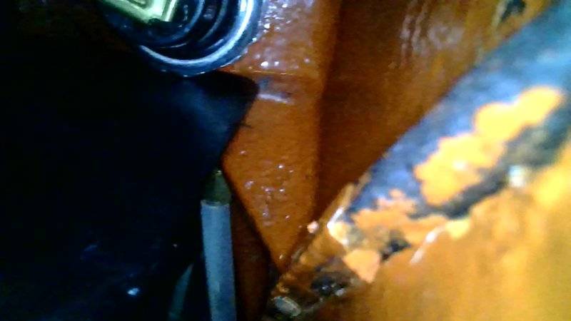

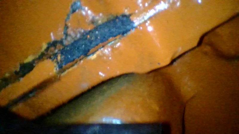

Looks like the easy solution isn’t panning out. Pulled the oil sender out and resealed it but it didn’t look like it had been leaking. After blindly rummaging around back there with my fingers I came across the intake gasket on the rear china rail is pushed way out in the center area which looks like the oil source. I don’t see how that easily happens as there are dowels across there to locate it. So looks like I will be pulling the intake in the future. Hate that - the paint on the intake and fasteners is perfect shape. Couple pictures.

Have you been running it hard and the PCV isn't hooked up or not vacuuming well? Been there with small blocks. Pushed out both china rail gaskets on a 318 that was seeing 6200......
I figured that is where you would find the leak.
No, I havent been running it hard. I’ve hardly had much chance to drive it at all for all the sorting out. I’ve concluded you never own a Hemi - it owns you. The pvc valve rattles good but I haven't checked the vacuum draw.

You may have repop fasteners which are not US made. I've run into stuff like that for awhile now. Threads are correct but you need metric tools. Bolts, nuts, fittings etc.
