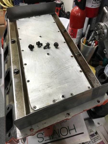

Could you use two piece sheet metal with 90* bend front and back of manifold to shield the china wall from splashing oil. You can use the splash shield on manifold to clamp the sheet metal shields.
You know Fran, I’ve been thinking about that very thing. It would be real easy to bend and trim a couple sheet metal plates to fold over and extend down about two inchs below the china wall on each end, bolted to the heat shield,to cut down on splashing oil getting to the joint. I think after you also mentioning it too, that I’ll look into doing so.:thumbsup:
Yes that's what I was suggesting. I would slide the shields under factory splash shied. If you could and get clamping power from factory shield.
On my motor with crossram the copper head gaskets go up to the chinawall all the way across valley. I took a piece of sheet metal with tabs to hook on head gaskets.

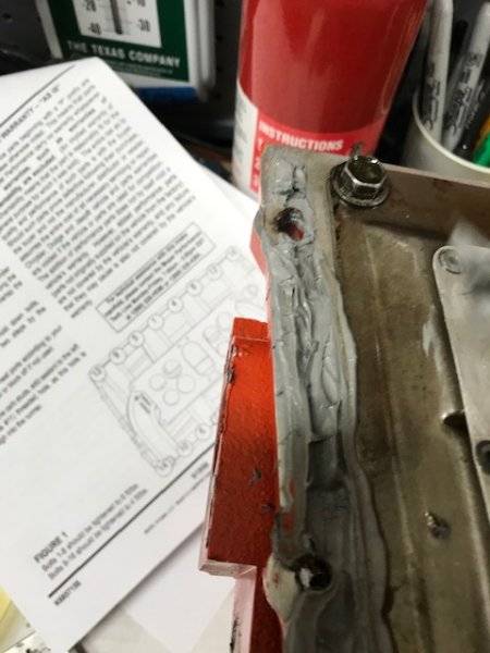

Interesting observation. When I cut into the RTV on the front with a knife it came out slimed and smeared in some places with some incompletely cured Ultra Grey RTV. This was over 48 hours after I installed the intake. I waited about 26 - 28 hours before starting the car but now I wonder if that was too soon. Wasn’t expecting this.
Well, this is the shits! Pulled the intake off and the Ultra Gray on the interior is just as fresh as when I squeezed it out of the tube. It was only set around the sides and maybe a very thin film on the metal. This stuff was about 52 - 54 hours old at the time of these pictures.
So, not sure what to try next but it won’t be Ultra Grey. I have some The Right Stuff but this experience makes me leery of RTV. I may go back to gaskets but it would take about a .18” thick gasket to seal up with 30 to 40% compression. Maybe I need to go with .030“ side gaskets instead of .062”?
Once it skins on both sides, it's like it's still back safe and sound in it's tube....
I let the stuff set for an hour on the manifold before I cleaned it off. It didn’t even skin over in that length of time. New tube bought on line, but has a date code of 2H. Could be 2002, 2012 or 2022.

Looks like it was a bad batch. I watched a vid on the Tube where a guy did, essentially, a shootout between different brands and grades of sealers. The OE stuff from the mothership was about the best.
Cut apart any RTV and see what it looks like after a day. Ultra grey always stays soft inside for awhile. Doesn't mean it doesn't seal. I've run stuff the next day with ZERO failures. Been using it exclusively for the last 10 years. My racecar has the motor plate/block /water pump along with the split upper intake sealed with it. No gasket, just sealer. None of the stuff I've worked on leaks a drop. Does this look like an engine that leaks?
What do you think Fran? They will hang down 2”. Another benefit, if I go back with RTV it will form a backup to the joint to keep RTV in the joint.
Looked at front china wall on my 66 Sat, gasket is hardly compressed. Block never decked .021 head gasket and no more than .010 off heads 1/16" intake gasket. You have that odd splash shield I forgot about that.
It’s a repaired splash shield. A center piece was broken out somehow and they riveted a piece of aluminum sheet over the bottom. Repros seem to be out of stock and this one, while different, is serviceable.
