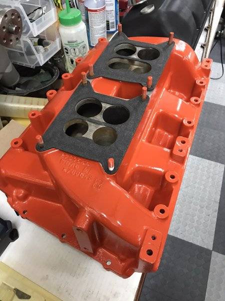

Slow progress. Received the gaskets and new intake bolt kit but one of the dowels apparently fell out of a hole in the parts bag and was missing when I received it. Mancini is sending a replacement but it won’t be here until Wed. I have everything cleaned up and ready. Took a bit of scraping to get remains of gaskets off the heads and about 20 wipe downs with denatured alcohol to get them clean. Ran a thread cleaner tap down all the bolt holes. The new Superformance gaskets are spot glued (RTV) to the heads. Decided the paint was a bit rough on the intake so I stripped it and repainted it.

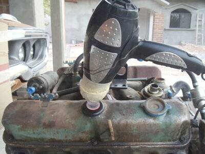

Discovered in all of this that the previous owner had not put all the brackets in the correct positions - tall bracket for carb spring and kick down rod was up front instead of the middle of the intake so I’ll get all that corrected during assembly. At least it was good to get a good view of the cam lobes and they look nice and smooth so I guess they got the cam broke in right. The green oil is from the dye in it. I took another look down the plug holes with my inspection camera but with the center located plug all you can see is the piston top or with the side camera the cylinder wall - which looks pretty freshly honed. But nothing hardly worth taking a picture of.
