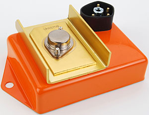

This may not be true. but if its is i have to make some changes. and install a Mopar Electronic Ignition Control Unit
