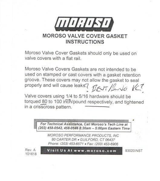

1969 440 rebuilt 4 years ago. Moroso 93055 Gaskets newly installed on Stock Valve Covers. Currently torqued at 40"lbs. Are you saying back off on the torque?
Generic Directions all makes and models from Moroso is 80"lbs for 1/4" thread fasteners. Seems like too much to me. FSM 40"lbs.
Have not run engine with new valve cover gaskets. Previous FelPro Cork gaskets were leaking, probably because of heat from HP manifolds.
