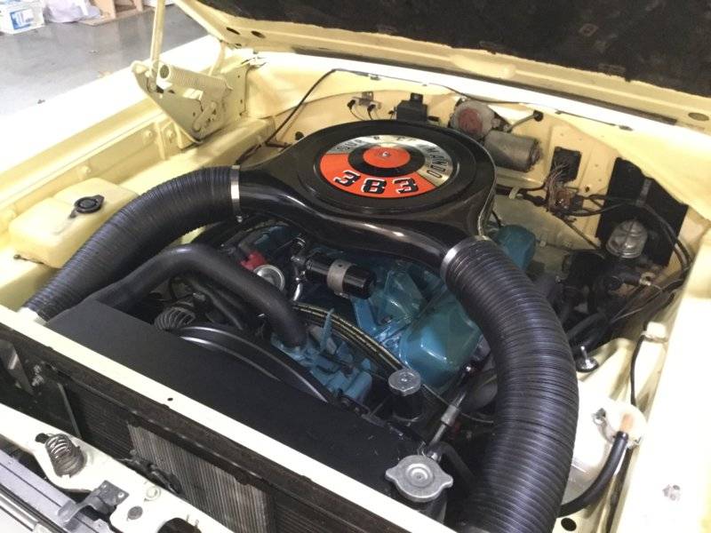

NO SCOOP FOR YOU!!!

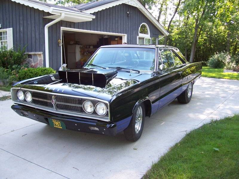

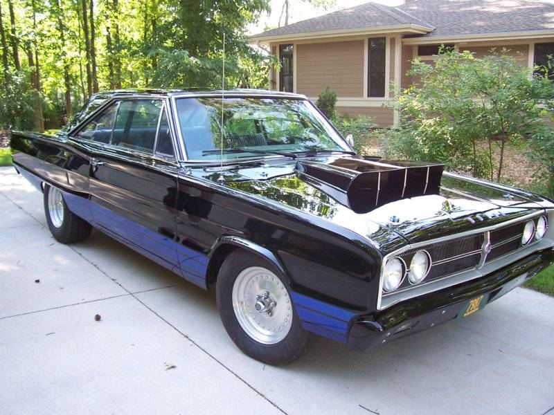

2017
5" Hemi Scoop from VFN, cut down to 4-1/4" on a steel hood. I had clearance issues with this set up, could only get 2" air filters to fit on the eddies. 68 lbs. Best of 10.39

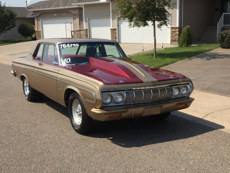

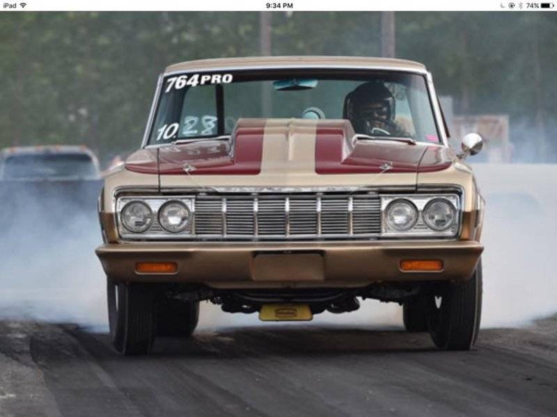

2018
Brutal piece of junk fiberglass hood, needed to completely reconstruct and it ended up with a 5" cowl scoop out of spite. Cons: Cowl scoop.... Pros: 16 X 5" air filter fits under. No bulging crossing stripes. 33 lbs. Best of 10.12.
2019: Switching back to the hemi scoop hood early into the season.

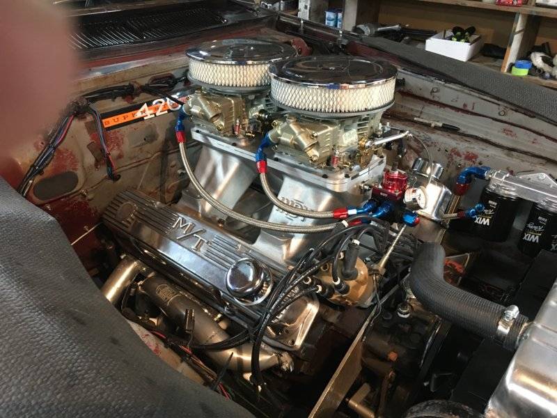

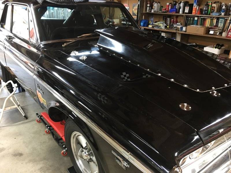

AAR hood with a VFN 5" scoop,made it hingable with pins and stock hinges,,to clear an indy tunnel ram,car will be running in a month or so and see if i like it or not,,if not,i will let the carbs stick thru the hood un covered...engine compartment will be painted this weekend,,

What's your opinion on fasteners holding scoop to hood? Unpainted or painted and why?
this scoop was designed for bolt or bond on..believe it or not the instructions said to use more bolts than shown..its bolted on for now to see how its going to be when driven,,i have since used a paint pen on all the bolt heads..i have seen scoops at car shows bolted on with galv fastners exposed,,,like going for a rat rod type look...
