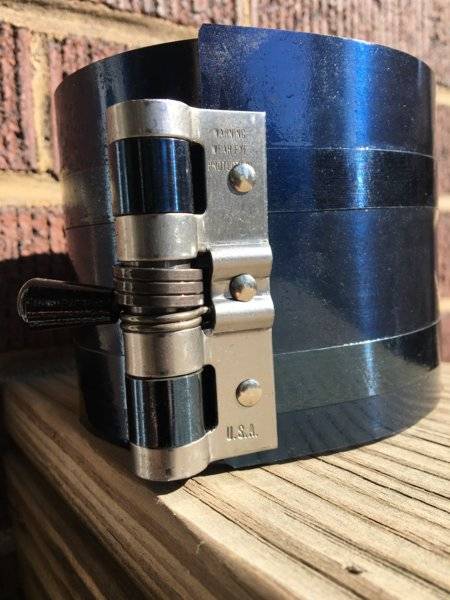

Well, I ended up purchasing this Lyle Ring Compressor through Summit, and much to my surprise, the tool is MADE IN USA!
I used this tool to install my pistons and it was easy-peasy! It can be a little tough as you operate this coated with oil - I tried to be neat!
I'm glad I listened and purchased this tool rather than the $55 ARP tool.
