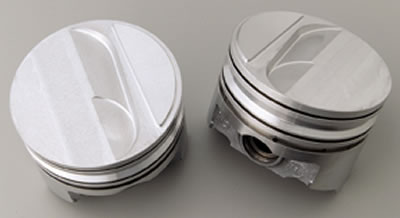

The KB236 piston is a quench dome or reverse dome piston, right?
That's where I first got cornfused early on......:)
Ahha... That is the case! the damn thing has a step on the "what would be flat" portion of the piston! Otherwise, it's a flat top... I still dont get it though.... Whay would you get it, then mill it flat? Whats the point in buying these?
Here's a picture of that thing...
Good Grief boys, this is a quench dome piston. It is designed to stick up inside the open chamber of the 88cc RPM or the factory large chambered head like the 906. The piston dome should be milled down to at least zero deck if he is using the .040 thick gasket with the 81cc Stealth head. Milling even further would be appropiate if required to obtain the desired compression ratio. Whatever that unannounced ratio may be.
This is correct. The question I have is he using open or closed chamber heads ??.. The quench pad piston is to be used in an open chamber head so you can try to get quench. Yes you can use it on closed chamber heads but you have to cut the quench pad off. At .033 above the deck if it is a closed chamber head and a .040 gasket you would only have .007 head to piston clearence. If they are open chamber its alot of work to get the .045 quench (head to piston clearence) that you want.
I used the KB quench pistons you see in this pic in my old 440 with open chamber 906 heads. This is just a mock up here as the rings are not on the pistons. You will need to install all the pistons and take all the measurements of how far the quench pad is above the deck and how far the piston flat is below the deck so you can also determine comp ratio. Then you have to measure the depth of all the open chambers on the heads and do the math including the head gasket thickness. Thats with open chamber heads. If they are closed chamber heads either get new pistons or mill the quench pad off.
the reason for the purchase was the fact that the original plan called for open chamber heads and then the wallet opened and stealth heads fell out:headbang: so now with the small step in the quench area I pick up a little more comp.by milling the step down from 0.060 to .027 i will pick up small amount of comp.:blob1:
yep, I figured that after seeing everything.... I have never used a piston like that in the past, so it took a bit of time before I figured out what was going on.
no problem guys, I have never used one either so I had to sit back and rethink it all. I was like why do I need to mill the dome down??? I was used to the "dome" being in the chamber area NOT the quench, but it is all good now and with what I hope to be a 10.5-1 motor it should work out fine, again thanks for ALL the input, the members on this site are by far some of the best!!!
