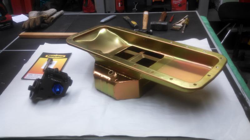

Update!
My pile of parts is growing! All we are waiting on now are oil pan gaskets, -12 90" sockletless fittings and some black -12 Aeroquip AQP socketless hose. I am very impressed by the quality of these parts and feel that they are well worth the money. Hopefully this will keep me out of trouble in the future.
