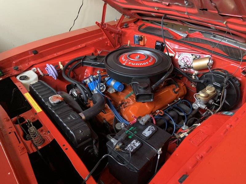

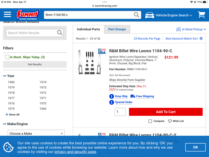

I used the Summit Racing wire loom RMN-1104-90-C. It keeps the plug wires up against the valve covers. I also used MSD 8mm wire kit and field fit the lengths for the new wire route. See pics below.

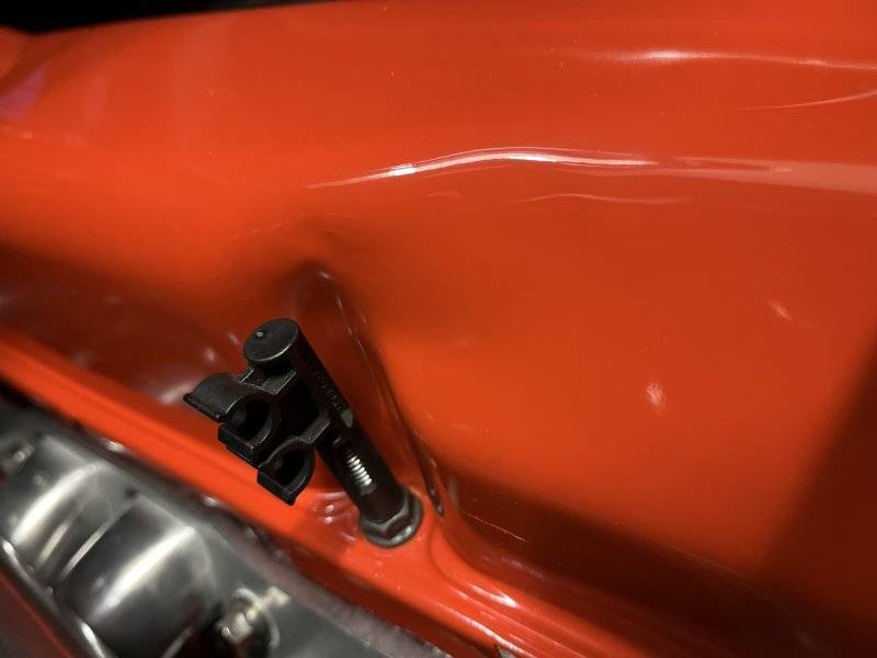

These plug wire retainers are from a mid ‘90’s Ram 360 engine. I ended up making studs out of 1/4-20 ready rod to get the length I needed. The retainers are ribbed on the inside to grip the stud. They were available in 2, 3 and 4 wire configurations.
