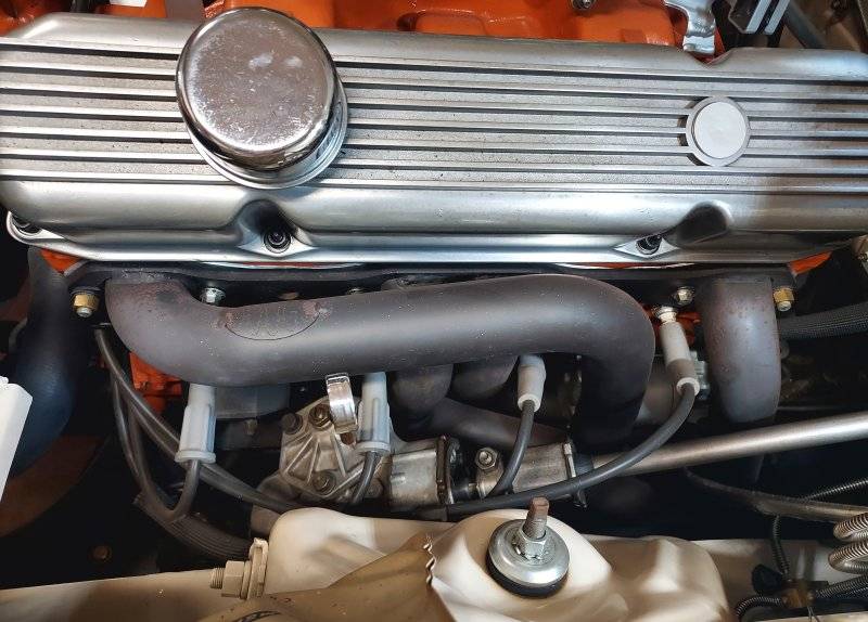

Firecore uses stainless steel clips. Their boots are great for headers. Not even discolored yet.

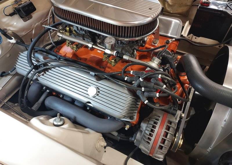

Got a pic?
Got a pic?
Nice unfortunately mine doesn’t have them clips wasn’t on the cat when I purchased it so I don’t know what clips and holders I would need so have to buy some plug wire holders
The wire loom and wire separators are actually MSD. You can buy them separate. I'm pretty sure I found them on Summit. They are real nice on how they are made.
