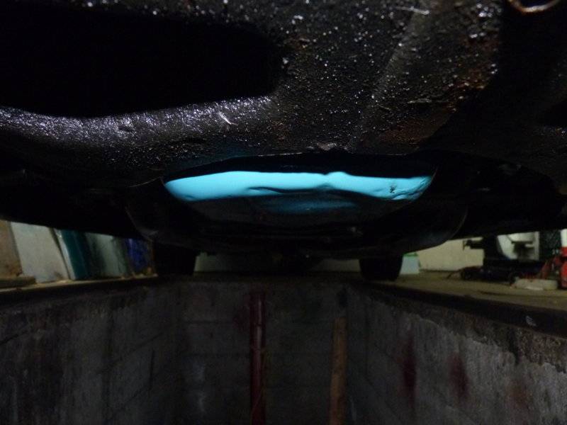

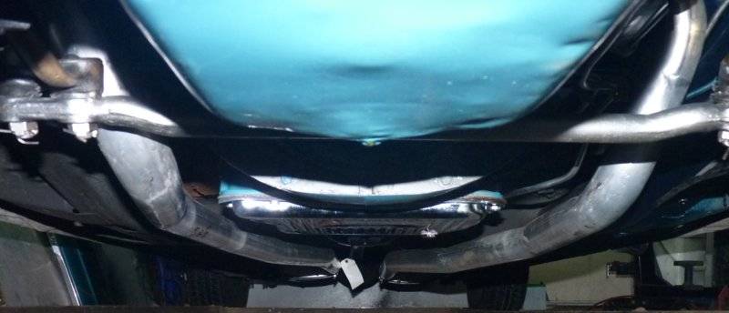

The mopar #971 oil pan will fit perfect Does not require any cutting and it sits up above cross member
i have a 971 oïl pan on my two early b body ,fit perfectly
