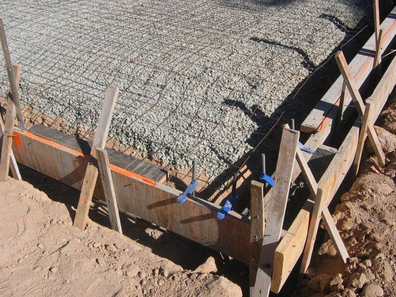

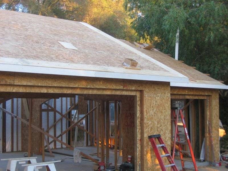

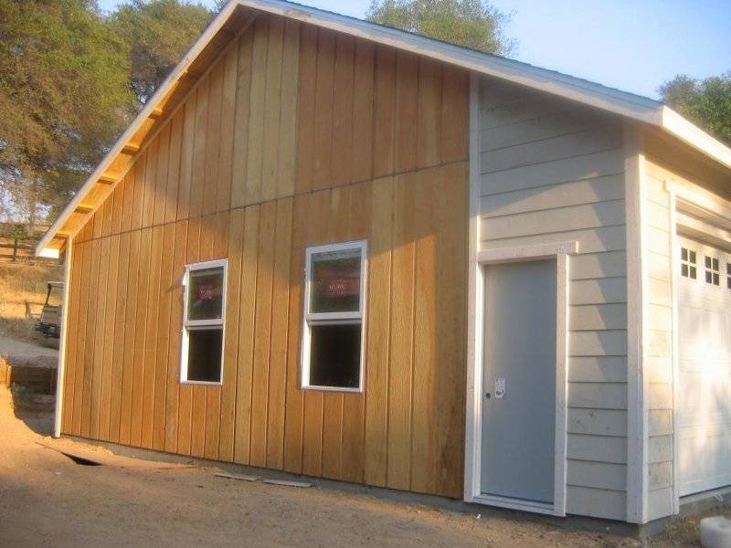

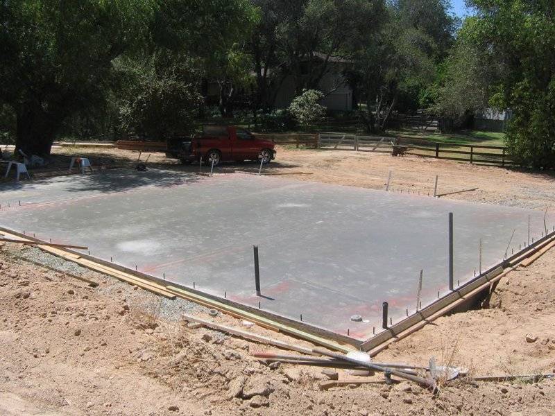

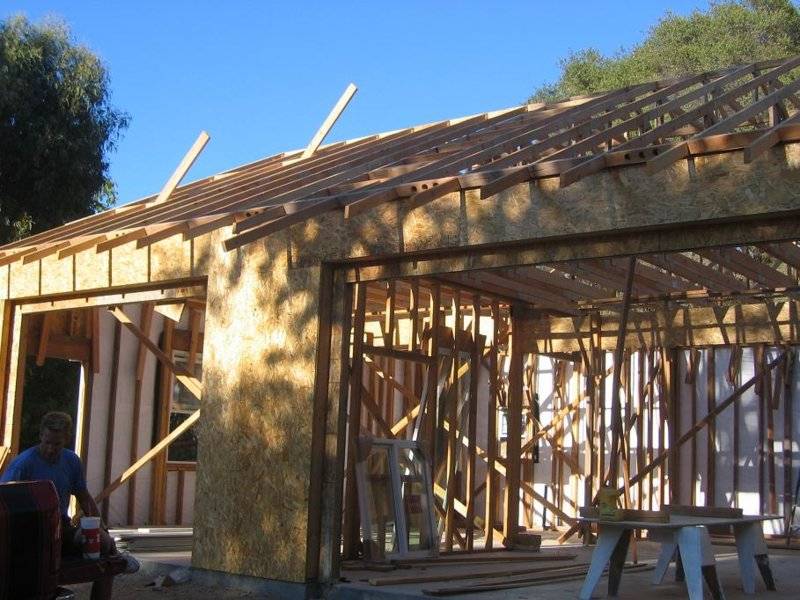

When I built my shop, I got quotes between $10 and $13 per sq/ft on the foundation. I am a great Carpenter/Framer but have very little experience with forms and concrete work.

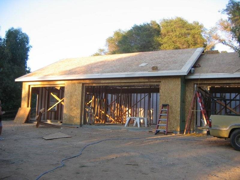

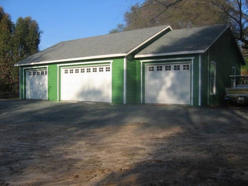

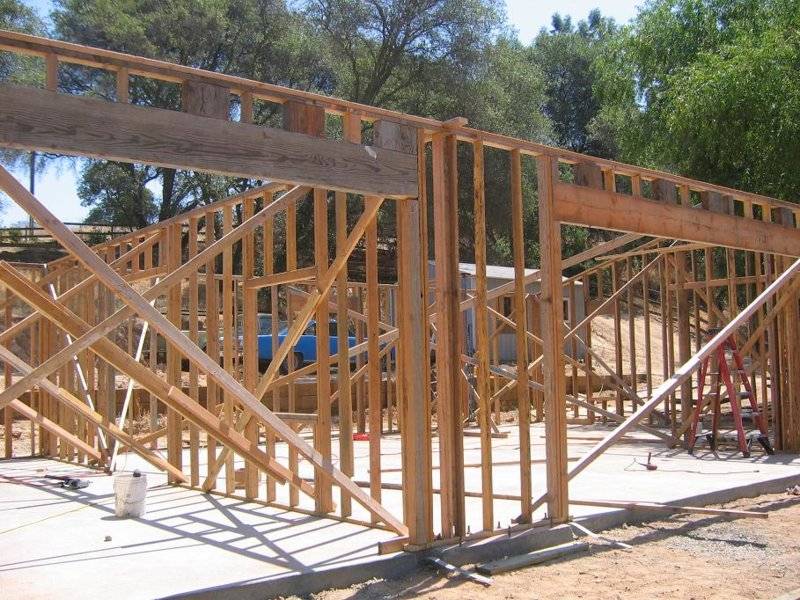

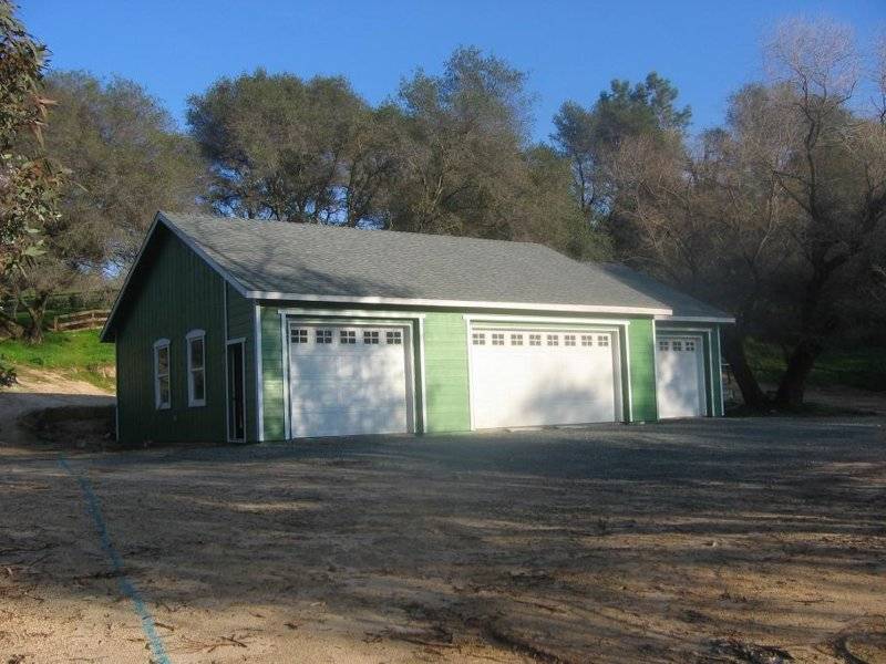

My shop is 1608 sq/ft. I did go with the lowest bidder but he did excellent work. California buildings have to comply with earthquake standards so deeper footings are common along with shear walls, closer spacing on anchor bolts, etc. Writing a $16,000 check stung a bit.

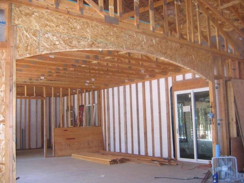

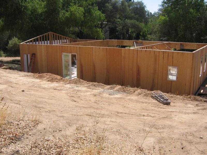

I got almost all of the lumber FREE from the job. All of the windows were new "take-outs" from model homes....a situation where the builder made revisions and chose different windows after the houses were almost finished. I had to pay for roof trusses, ($3500) roof sheeting plywood, paper and shingles & a guy to shingle it, Three garage doors and two prehung 32" doors.
I had the guys put these huge footings in where I planned to install the 2 post lift: 24x24'18 inches deep.

I did have the trusses built to have a 5x8 pocket in the center for attic storage.
