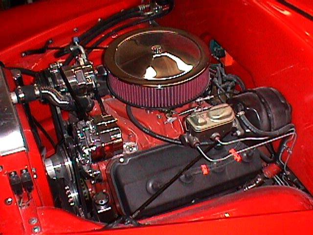

It's beyond me also why one would want to put Poly heads on an LA engine. If I ever see dyno sheets on a successful project, maybe I would support it. Here's a photo of my 359 cu.in. 392 hp. Poly stroker.

"LA" heads on a Poly block pictured.

That's awesome. For whatever reason, the pics didn't show up for me till now. Badass.

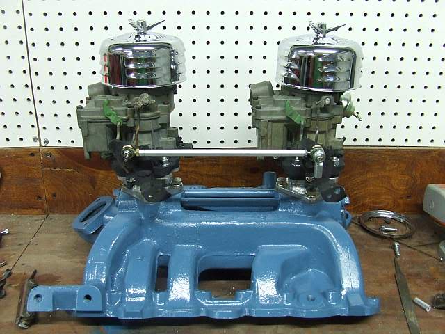

Check this out. This is my induction. Two 350 CFM GM 2GCs on a two one barrel high rise fire truck intake. Since it's a wet intake and I HAVE the thermostat housing too, that kills several birds with one stone. It'll look cool as all snot in somethin. Whatchyoo reckon? Is that total badassary or what? lol
Check this out. This is my induction. Two 350 CFM GM 2GCs on a two one barrel high rise fire truck intake. Since it's a wet intake and I HAVE the thermostat housing too, that kills several birds with one stone. It'll look cool as all snot in somethin. Whatchyo reckon? Is that total badassary or what? lol
Definitely a pre-55 intake and old school for sure. Should look awsome sitting on top of just about anything. :hello2:

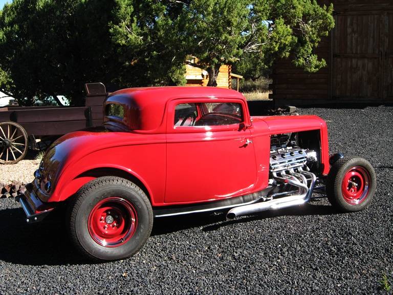

Can't figure out how to post a video here so here's a short clip of the hemi in my deuce with the tri-power setup.
