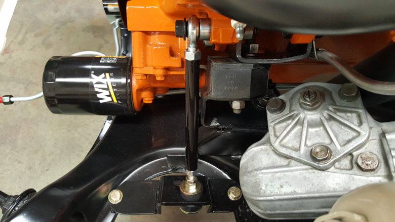

I just used factory mounts and added a Schumacher torque strap. This one was a "E" body one I found on eBay for half the cost and just had to use a spacer.
that is an excellent precaution. After running solid homemade mounts, I decided to change back to stock mounts. Well, the chineseium biscuit broke shortly thereafter, sending my fan into the radiator. Got the poly mounts then, pretty good.

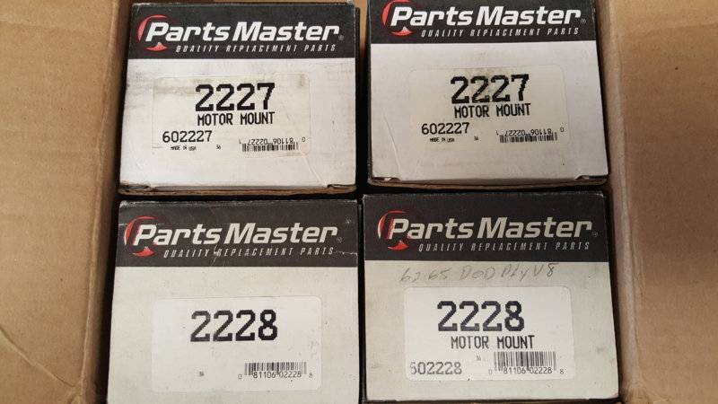

I was lucky enough to find a set of NOS mounts (made in USA). I heard that a lot of the aftermarket ones weren't holding up. I would have went with the polylock but they were backordered and expensive.
