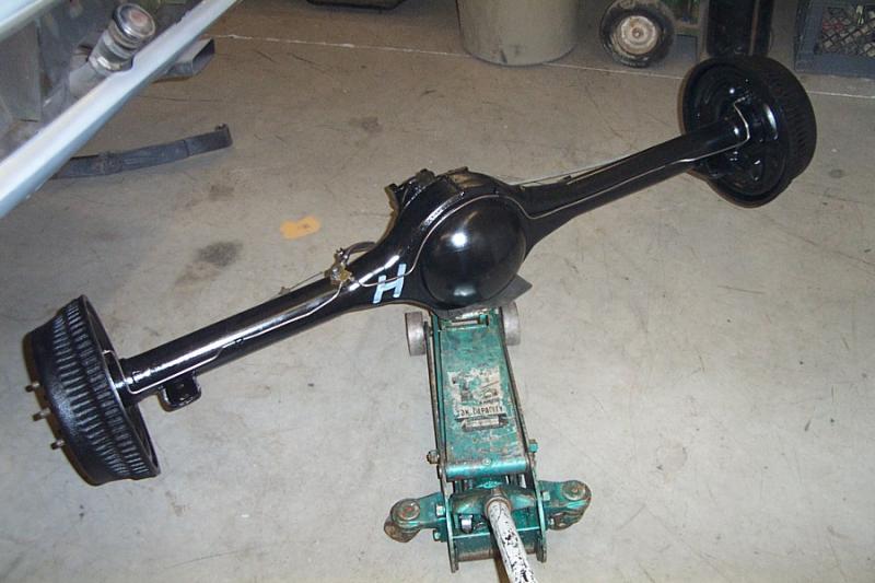

I like it. Not sun light friendly though. Can paint over it. I use it on rear end and suspension parts. Great for leaf springs. Also on the under carriage in spots and down in between body panels. Lower quarters, extensions, rockers, ect. This of course is not on a 100 point show car.
Used it on this rear in my 72 beater.
