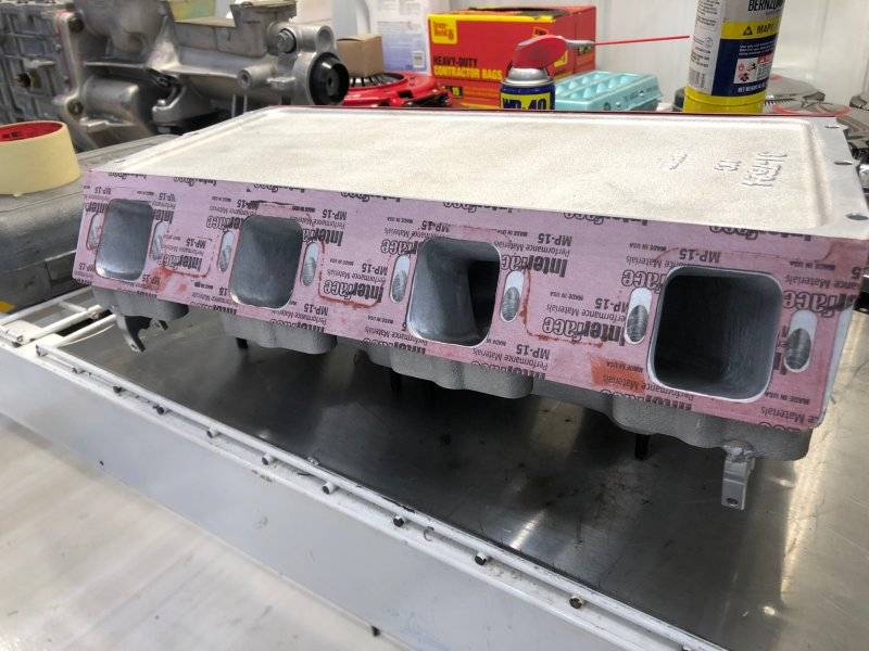

What I did was get gaskets slightly smaller than the port. Tape them in place with painters tape and cut the gasket to match the head port with a razor.
After milling the intake to get it closer I put a few drops of glue on the intake side of the gaskets, install intake and torque down, leave overnight.
Removed the next day and gaskets stuck to the intake of course, then used a sharp pick to scribe the gasket ID to the intake face.

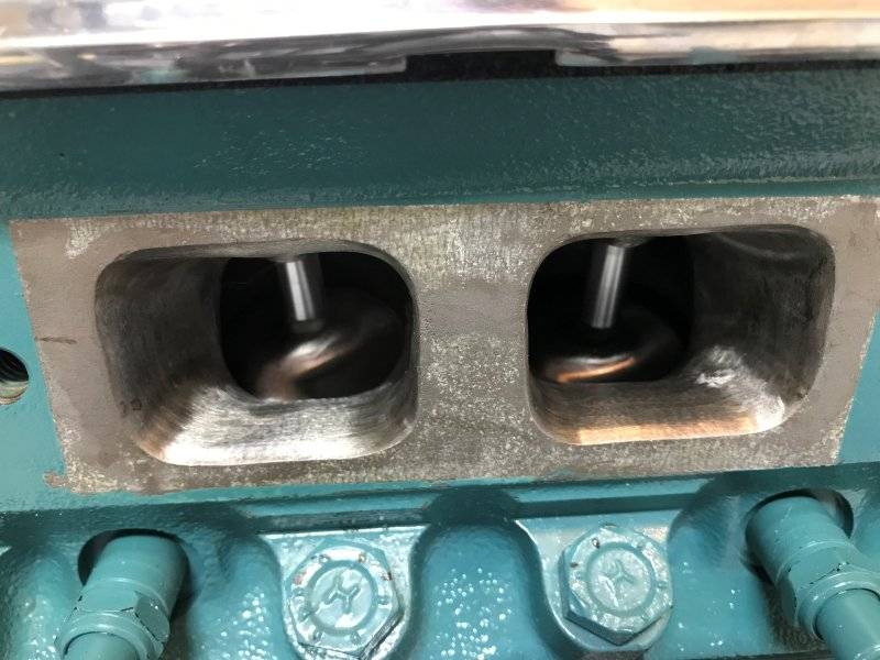

My bet is the amount of mismatch makes a big difference. If you do your own head porting like I did, not much effort. On the 360 I did for my tow van, the Fel-Pro 360 gaskets were the dimension I matched to. Made the heads match the gasket dimensions and the LD4 intake match both. Worked great, lots of towing power.

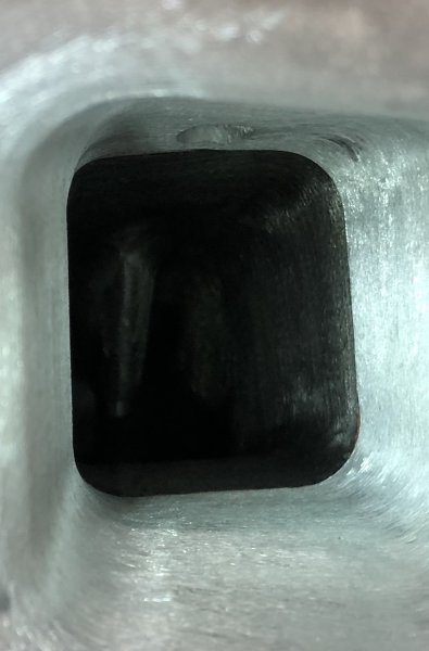

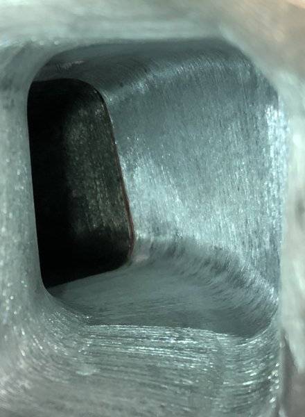

If it were my engine (and I just built a 416 stroker out of a 340), I would port match them. It won't take long at all to open up the aluminum intake manifold ports and blend them back about 1.5 to 2 inches.
Yes, the performance gains will likely not be huge, but any rapid step in port size will cause fuel to more easily drop out of suspension and flow through the engine unburned. Look, I know we don't build these engines for economy, but why burn more fuel that you need?
