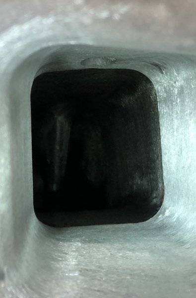

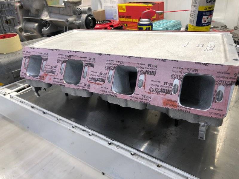

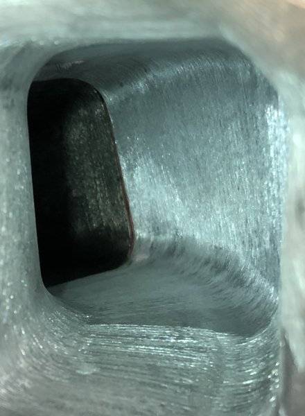

I did it on my engine, not sure if it's worth it as I didn't do a before/after test.
I think I would do it on yours given the difference in dimensions but can't imagine it hurting much if you didn't.
(and as mentioned you could make it worse as well)
What I did was get gaskets slightly smaller than the port. Tape them in place with painters tape and cut the gasket to match the head port with a razor.
After milling the intake to get it closer I put a few drops of glue on the intake side of the gaskets, install intake and torque down, leave overnight.
Removed the next day and gaskets stuck to the intake of course, then used a sharp pick to scribe the gasket ID to the intake face.
View attachment 1353430View attachment 1353431View attachment 1353432
Everything that INTMD said. If you’re going to do it, match to the head, not the gasket.
