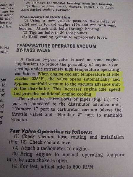

I was doing a little light reading today and came across this tidbit. (73 FSM)
It follows that if the factory was using manifold vacuum, it would be impossible to add it when needed.
I was doing a little light reading today and came across this tidbit. (73 FSM)View attachment 1081479
Ford also did that during the emissions time when the cars ran leaner and more retarded timing so they ran hotter. The only thing that 3 prong valve does is normally it lets ported vacuum work the vacuum advance so it has no vacuum at idle and gets vacuum after stepping on the gas. Now if the car gets to hot the valve moves and sends manifold vacuum to the vacuum advance at idle so the eng speeds up and the fan pulls more air and the advance timing also helps the eng run cooler. Thats all that valve does is help cool the eng if it runs to hot. Ron
I also dont believe the manufactors went to ported vacuum for emissions because as far as I have seen many used ported vacuum way before they started retarding idle or off idle timing for emissions.
