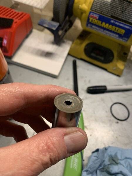

Wow, I haven't seen that sort of wear that wasn't in an Oldsmobile.
Good job of troubleshooting.Bad news confirmed. Hole in lifter, damaged cam lobe and metal everywhere.
Man, that sucks. I think I'd have one of them stiff drinks like in your avatar! Whats the story with the motor? how many miles on it, what oil and additives were you using, was it a new cam....we are all curious.Bad news confirmed. Hole in lifter, damaged cam lobe and metal everywhere.
That can contribute to it.....but there's lots of other reasons it could happen too. Metallurgy can also be a factor. Years ago one of the larger car makers had a LOT of problems with cams going flat. Too much spring pressure is another and improper break in can also contribute to it......What causes that?? Low zinc oil?
Sure. Engine was built 2 years ago. Has maybe 8,000 miles on it. 3 months ago I switched from VR1 to Castro GTX with Hotshots secret FR3 friction reducer. Figured it could benefit from an oil with more detergent. Maybe the cause or not. I will say I replaced my valve covers four weeks ago and checked all the rockers and they were solid tight. Whatever happened happened all of a sudden as there was no ticking or anything previous to my one hour highway trip last weekend.Good job of troubleshooting.

Thanks for the info.Sure. Engine was built 2 years ago. Has maybe 8,000 miles on it. 3 months ago I switched from VR1 to Castro GTX with Hotshots secret FR3 friction reducer. Figured it could benefit from an oil with more detergent. Maybe the cause or not. I will say I replaced my valve covers four weeks ago and checked all the rockers and they were solid tight. Whatever happened happened all of a sudden as there was no ticking or anything previous to my one hour highway trip last weekend.View attachment 1249287
Comp Cams.Thanks for the info.
