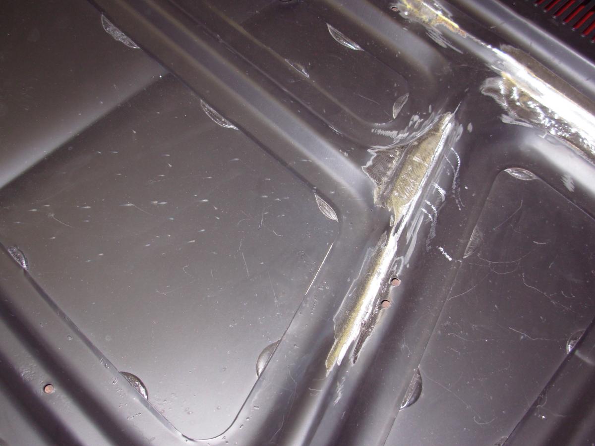

Here is a pic of the underside. You can see its not attached with the glue. I tried taking pics of the skin where it dips etc. but you cannot tell from the pics. But i can say that it only dips in between where the braces are.

Hmm there shouldnt be a dip there at all..I think either he stepped/kneeled on it by accident or there was prev damage and the blasting took off the repair..imo

I dont think that was the case because there are four distinct spots that there are waves. Like I said all in between the braces. But when I push under neath of them they seem to pop up fairly easy from what i think is the old glue. Most of the glue if its still even there it is not attached to the skin. So im thinking that it is because of the glue so maybe ill try that first before i go out and get a new hood. But if anyone else has another idea let me have it.

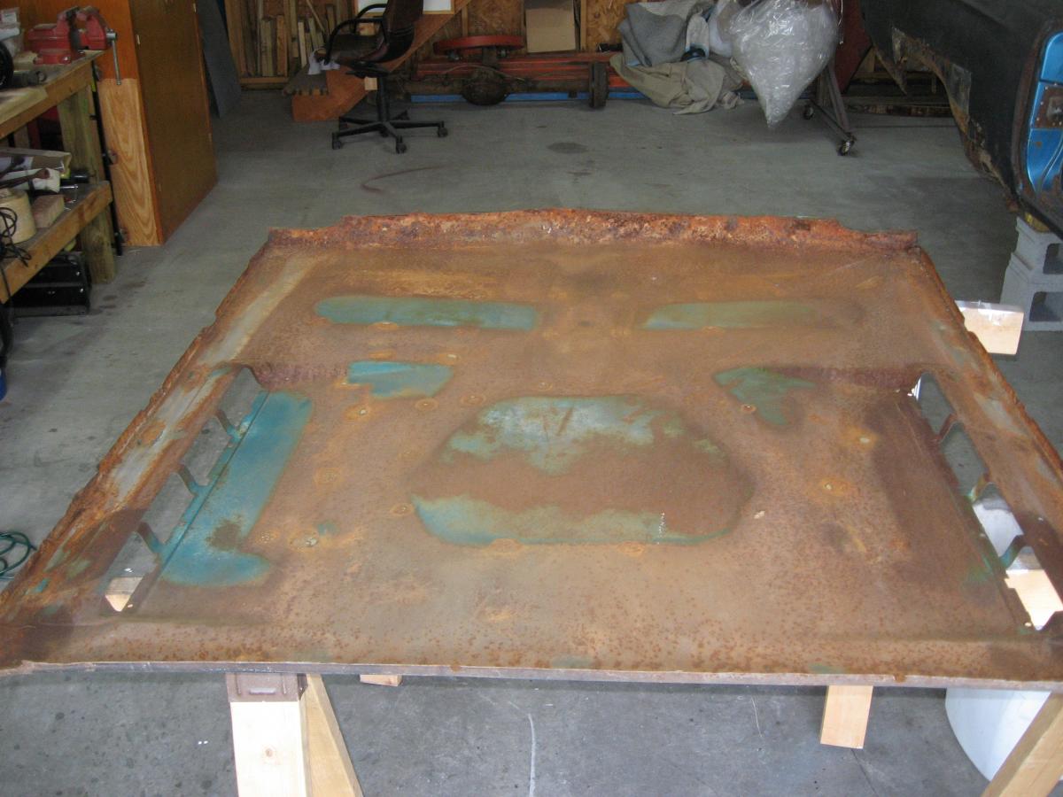

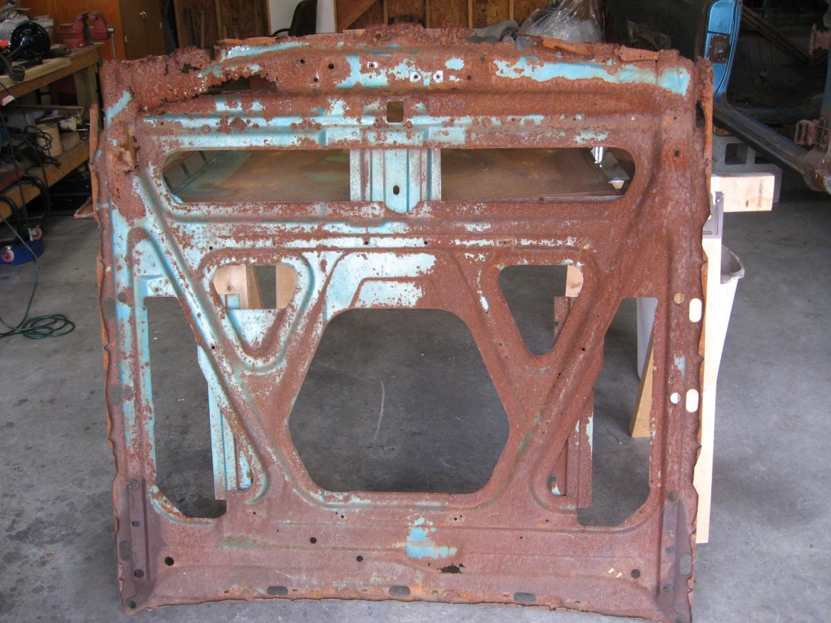

Check it out...

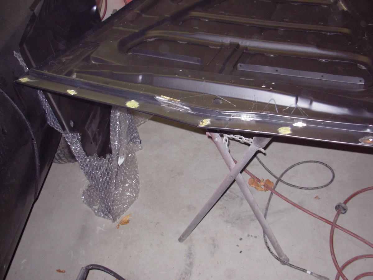

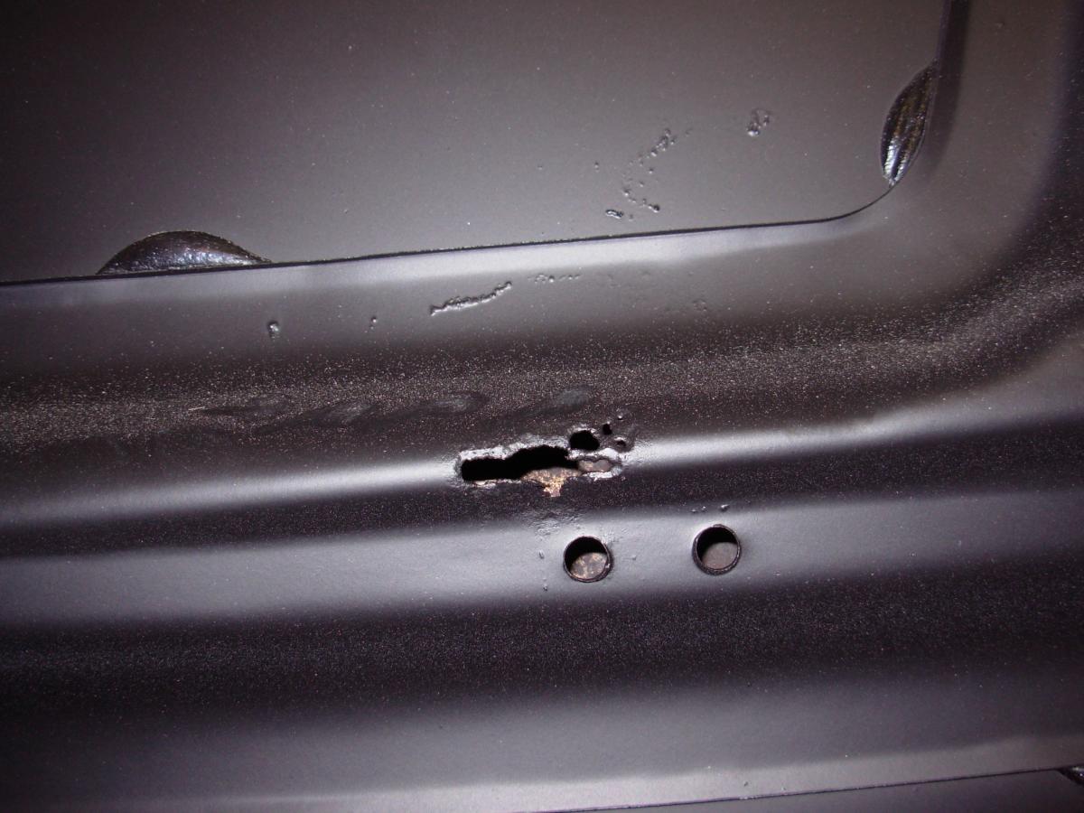

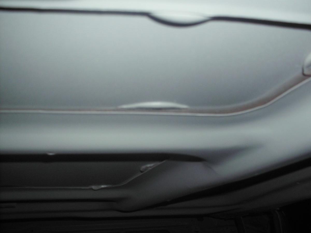

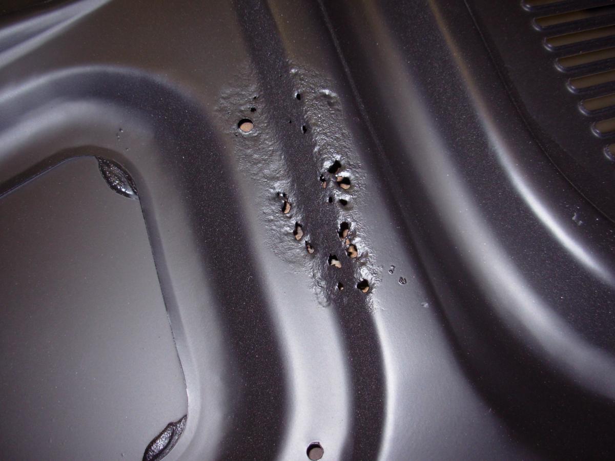

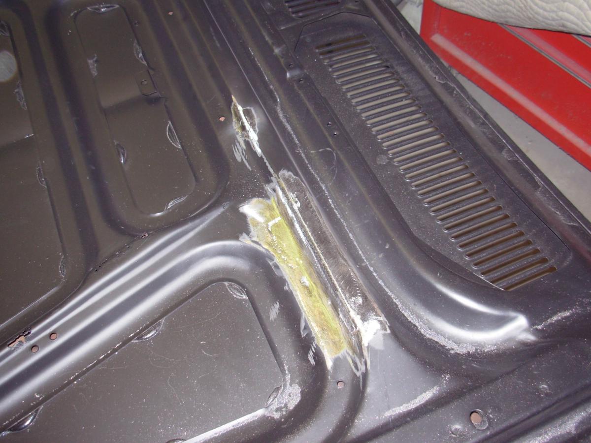

Ya really,I thought the 72 was bad holy ****.These issues I fixed seem feeble compared to what evers left of what ever that might have been:violent1:
