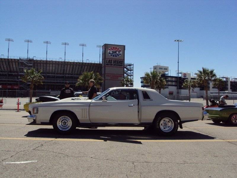

Blown and stroked small block in a 1979 Chrysler 300. Best of 10.50 @ 128.35. Yes, it's for sale.

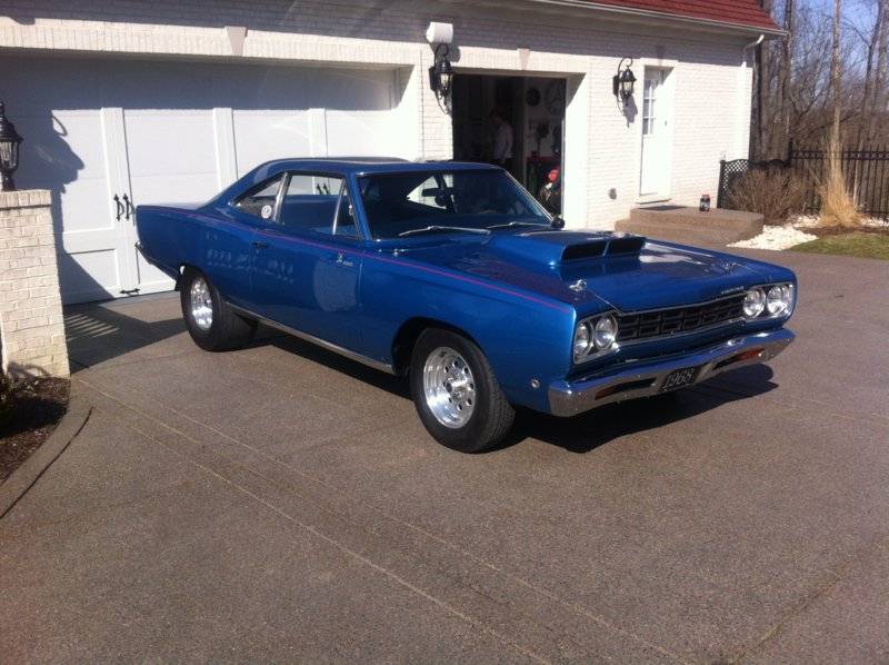

1968 Roadrunner, Original owner, mostly street car that I race occasionally.
493 stroker (440 Source stroker kit)View attachment 602148
Dana 60/4.56's
Victor intake with 1050AN Quickfuel
Eddy RPM's cut to 76cc's
Hooker 2" headers
Scott Brown SFT cam. Duration, 259/266. Lift with 1.6 rockers, .623"/.627"
Compression ratio, 11.8:1 on 93 octane pump gas
Stock 18 spline NP833 transmission
Centerforce 11" clutch
Full interior, (radio,heater, front and rear bench seats, carpet )
Total weight with me in the car 3926#
Best time to date 10.99 @ 125 mph
Hey I know you ! That's one sweet Roadrunner that runs and looks awesome. Nice to see you here. Ron

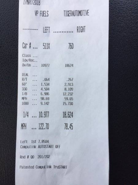

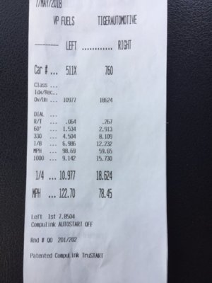

Well the little 440 is a second slower then the 511.
Ran what I expected and is consistent. So that’s how I’ll roll this season.
The 440 sounds real good at higher RPM.
Raced a new Demon today. Lucky me he doesn’t know how to use his new expensive car yet. But I am sure he will soon, then I’ll be in trouble.
