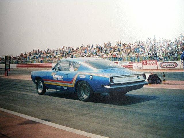

This was in a 3300lbs@the line A body..(sorry guys) back in 1991, cheapo build..
Stock 1968 446-6pk bottom end, internally balanced, around 9.8:1
Comp. Solid .650/.650 290@.050
Ported 906's w/2.14-1.81..approx 260cfm
HS Roller rockers, Roller springs w/small spring removed
Team G int., 2" spacer, modified 850DP
2.1/8" F/well hdrs made from BBC hdrs.
no alternator, electric w-pump.
motor made 531 on track fwhp.
shifted@6300 trapped@6700
4.88's, 32" Hoosiers.
ran a best of 10.71@125 @SPR
actually only ran it once NA with this set up as hit it with N20 after.
for motor specs info really.

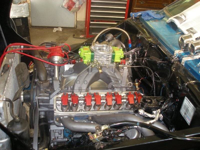

74 Duster. 451 B-block stroker. BME aluminum rods with Ross pistons. Just a Mech lift Comps cam at .590 lift. (Can't remember exact duration.) Brodix B1/BS heads. on single 1050 4150 Holley metered to e-85 fuel, Compression about 12.5:1 Reverse valve bodied 727 trans to 8 3/4" Mosier spooled/axled rear with 4:56 gears.
