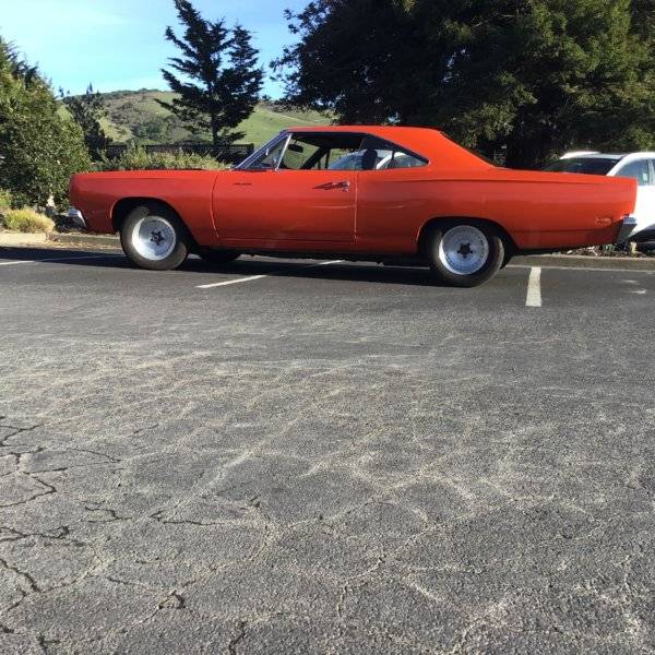

My old yet current combo. 69 rr, all steel except hood, 3850lbs with me. Dana 3.54, pinion snubber, frame tied. Sloppy 496”, built 727, Dynamic converter approx 3000. Comp cam sft around 246@.05 I think, can’t find card, Edelbrock rpm prepped by Hughes, 850 M Demon annular, 1-7/8 headers, 3” h-pipe exhaust dumps at axle. Car is set up to handle with oversized torsion bars, F and R sway bars, very stiff. Best of 11.49@117, through muffs, calm night, 70ish at Sears Point. Idles at 900 rpm with 13hg.
17B25BF9-3E75-49A8-9BC9-CA1809D7F2AC.jpeg 2D17AA4F-39E8-4A36-B32A-BEDA6E46BB35.jpeg 57F2A7A1-9DA6-490B-8B95-FA0866EA2D37.jpeg 184D47DC-1CF0-4A93-99A7-8EB87A4EC65D.jpeg 3BDE545E-EC80-4484-9930-7909D9732898.jpeg

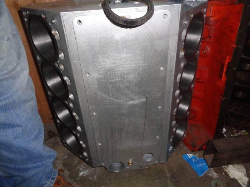

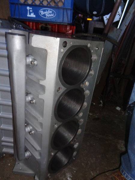

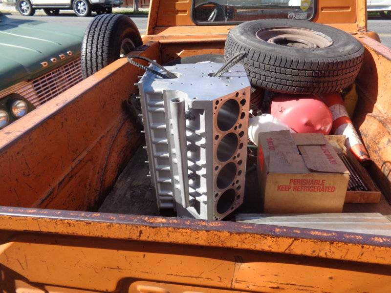

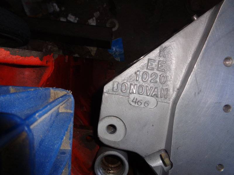

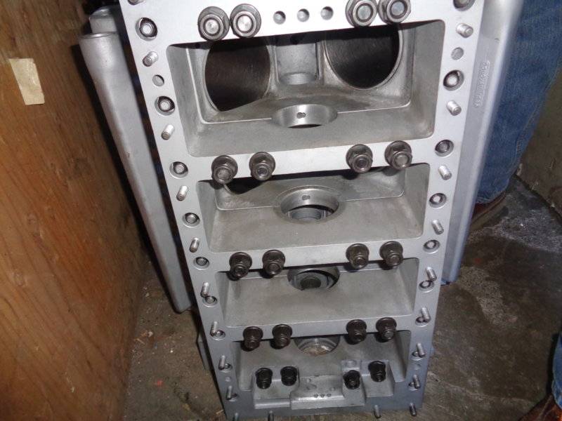

yes i know there almost hens teeth in calif . but its lic/reg'd street car . and i havn't lost my drivers lic in awhile , lol . just waiting for parts to finish that big inch max wedge package . got a little side tracked , just bought this donovan 417 block and making a deal for his molex cranks for that block . and i'm looking for some cherry or virgin donovan wet heads , lol . i know the odds , at least some that havn't been raced over to much . i've got some time before the chassis is done for this a40 austin maybe be swapping it back n forth between my 27 t altered roadster and this austin . so i can be a bit picky . i got studs and extra bore sleeves as well . again these cars will be street cars as well .
yes , stays together even at 3000 hp at 50 psi of boost . i'm only looking at 1500 hp out of it in my austin a40 or my 27 t . both are light cars . and of course it tobe blown , so i can keep the rpm down .

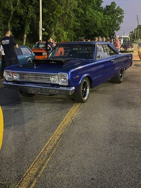

Been awhile to do the update. have the car sorted out pretty much. Have not taken it to a dyno yet to find out how much we are putting to the ground. Got the 4.89 gears put in and went with 13x31 Mickey Thompson's. Its a slick they make specifically for heavy automatic cars. Last time out we were able to get a 11.28 out of it, broke out on the .33 dial in. MPH is slightly over 119.00. Will be nice to dyno it and get it fine tuned and then see what she does!
Also to answer a previous question, yes those wheels are made by a company called Monocoque.
Also to answer a previous question, yes those wheels are made by a company called Monocoque.View attachment 942860
I'm guessing 410 at the wheels.
That would be good. Car weighs 3540 with me in it. The track is in Albuquerque @ 6000 ft. You think it would be that much?
Nice running and looking car !! Ron

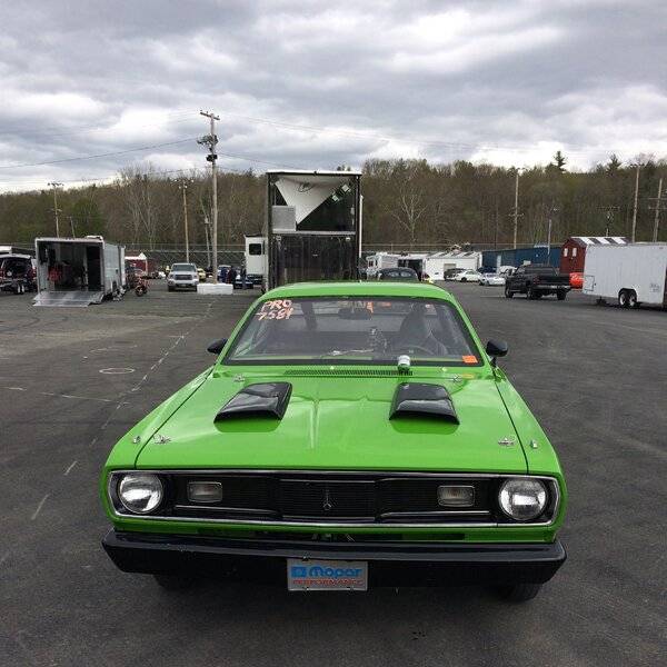

71 duster 4.56 gears 4500 converter, roll cage , 363 , 12.5.1 j heads ported by dwayne, 750 quick fuel, 567/574 266 268 flat tappet. 11.38 118 mph. 3100 lbs

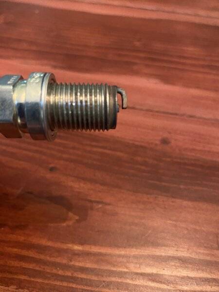

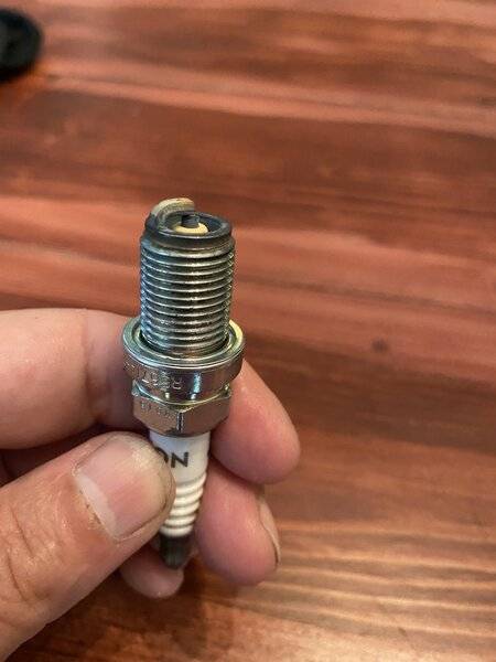

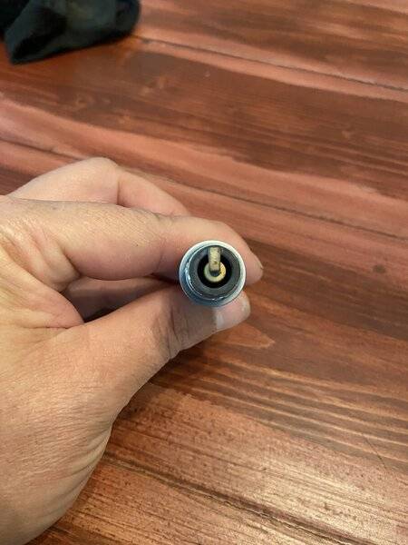

Made a few shake downs, best time was 7.28 @ 96.33. 1.65 60ft
My personal best BEFORE all these mods was 6.97 with a 1.56 60ft that was with the Fitech efi also. Running carb now. I’m sure it will run quicker next time out, but not sure how much. Any thoughts on the plug?
I wish my plugs looked that clean! No oil showing and not a bright white insulator. If it’s not pinging, it sure seems healthy
