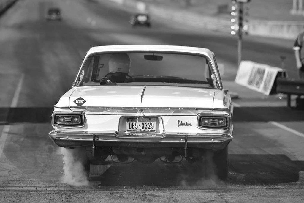

Ran the car for the first time in the 1/4 and ran a best of 12.88 @ 107. I feel like the car should be low 12's. 60ft is like 2.01 which is terrible, also the track was at 4,600 DA that day.
Car is full weight, 68' Coronet in full trim expect for battery in the trunk and no spare/carpet in trunk.
I was foot braking it and the pedal was sinking a little so I couldn't get the car to hold at the line above 2,000 rpm or so. It ended up being a leaky wheel cylinder in the rear. That and the car was throwing v belts at half track which cut off my water pump. It was kind of a stressful day, lol.
Specs.
446ci 10:1
727 Cope RMVB Trans, 3,500 Stall PTC 9.5" Converter.
Lunati 60304 Cam
3.91 Gears, 8.75 axle
28" Drag Radial(Nitto 555r, 275/60)
OOTB Stealth Heads
Hooker 1 7/8 Headers
2.5" Exhaust through Dynomax mufflers out the tail
318 T bars, Stock Pinion Snubber
Fitech EFI 600hp Kit, A/F ratio was spot on all the way down the track.
I just dont get why it wasn't faster. Maybe I just need more practice(4th time to the track ever), Got a line lock now too which should help getting the tires warmed up.
That's a similar time and MPH I was running before I went to Trick Flow heads. (12.87@106, 1.78-1.83 60') It's definitely the 60' time that is hurting you. Were you overpowering the track and spinning off the line? Maybe it's the tires. I'm not too familiar with Nitto tires.
Your MPH does seem low for having Stealths and that cam. What are you shifting at and what's your timing?
My 69 RR with a 451 and 915 heads, similar build, 3.91 gears, auto, 28" slicks, 509 Hyd cam, runs low 12s at 5600 feet in Colo. Street Dominator intake with a Holley 850 carb. The main difference? I run 13 to1 C Ratio. That seems to help alot, especially at altitude. Did you open up the headers? That helps too.
I see you're using EFI. What is the intake manifold like? Is it an individual runner type such as a Torker, or a Victor?
I was running through the mufflers. Shifting at 6k, timing is set to 18 base and 36 all in around 2,400 or so. Not much tire spin off the line.
Running a Holley Street Dominator single plane. I'm thinking I just need more seat time, the brakes were kinda leaking that day which ment I couldn't really do a burn out or hold the car back(foot braking) at the line.
Same intake I use. The main difference here is C/Ratio. I don't think a home ported 915 head is going to flow much more than a Stealth. They say C/Ratio doesn't make much difference, but experience has shown to me that it makes a BIG difference. As much as 1 second and 10 MPH, for say 10 to 1, vs 13 to 1. I think part of the improvement comes from better scavenging of the spent ex gas. I've built alot of 440s, and the high compression ones make WAY better power.

  1. I would definitely open up the exhaust at the track. Some would also argue that a 2.5" exhaust on that setup is holding the car back, so uncorking it would negate that.
  2. You need to experiment with the shift points. You might have a little more rpm (or less) in the car
  3. You definitely need to heat up the Nitto's and fix the brakes. You should be pushing 2500-2800rpm on the line at least.
  4. And speaking of staging techniques, I like to stage shallow and when that last yellow hits, floor it. That gives you momentum off the line before the clock is triggered. With hot drag radials, it should hook for sure. If guys are running in the 7's with them, no reason you can't run 12's.
  5. Fix your V-belt setup
Thanks for the tips!
I've since fixed the V belts and fixed the brakes AND added a line lock. So now I just need seat time! Going to be a fun summer I'm thinking!
