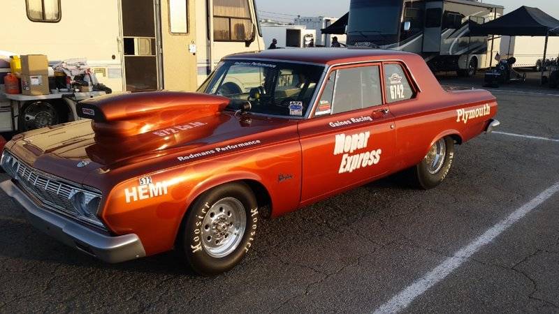

My combo:
64 Belvedere. Glass hood, deck lid, bumpers, lexan side windows. 2965 pounds empty.
15x14 Weld rear wheels with 14x32 Hoosiers.
MSD 7AL-3 box. 2 deep cycle batteries in trunk. Mallory 140 pump with 8AN lines to front.

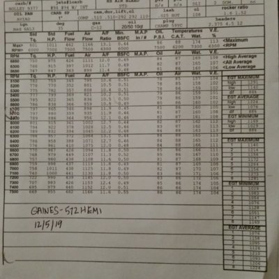

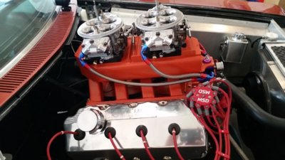

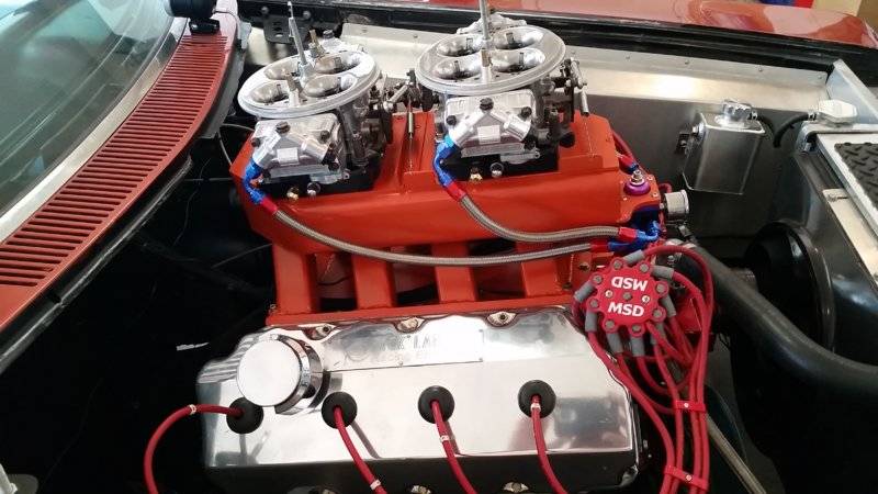

572" MP Iron Block. Bill Mitchell (BME) Forged Aluminum Rods, JE 14.5-1 pistons, Hansen Stage V heads flowing 540 and Hansen Stage V Rocker Arm assemblies. Comp Roller with .816 lift, .298 duration @ .050. Manton push rods. Manley triple springs and Manley Titanium Valves. Sheet Aluminum Fabricated Tunnel Ram with 2 1050 Dominators modified by Braswell.
Custom Fabricated headers.
Makes 1011HP at 7100RPM / 801 Torque at 6000RPM on Dyno.
Pro-Trans Torqueflite with standard upgraded parts, sprag, etc, etc. Billet Aluminum Drum. CSE Transmission shield. PPG (Precision Products) rear exit cable shifter.
Dana 60 with all Strange parts, spool, axles, etc. RR drum brakes. Wilwood front Brakes.
NHRA certified cage. Kirkey Seat. Diest Parachute.

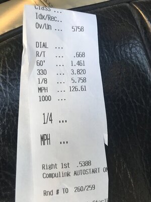

Surprised it didnt like the 4.30s. I've run both 4.10 and 4.30. About the same. Last weekend we ran right across the lake at Ubly. 1.261, 5.747, 118.97 with 4.30s, 3360lbs.
Doug
No way the gear alone killed it .25/4mph unless something is mismatched. Was the weather the same? 800hp@2653 should be in the 8's at way over 150 mph in the 1/4. Something is missing. The trick is to find it. It can get frustrating. Good luck.
Doug
The obvious things proper timing, fuel delivery, full throttle. If you find nothing I'd be looking at the converter. Even screwed up your motor has way more potential with its list of parts than its showing. Good luck.
