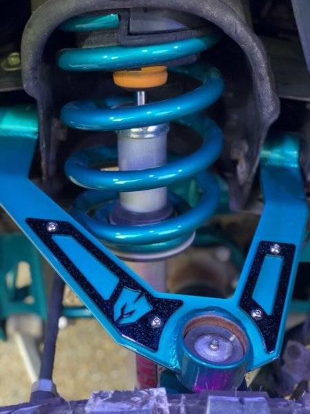

I coat pulleys and brackets all the time and have never personally experienced belt slip nor heard about it from any customer; if you do, tighten up the adjusting points.
Powder coating can also be waxed and even buffed. It's usually not necessary if you chose the finish / gloss rate you like to start with. It also won't wear as quickly and will be more durable than liquid paint (years/decades versus months) assuming the prep is properly done.

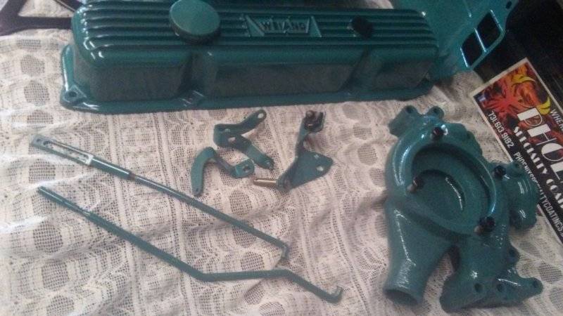

Keep in mind though that ANY steel or aluminum left bare will attract moisture and eventually start to corrode. Leaving the v-belt groove bare for example will invite an industry term called "creep," where rust will form on the bare steel and creep all over the part underneath the powder ... and one day your wrench will slip, hit the pulley and a big sheet of powder will fall off. Proper prep (media blasting and cleaning) will minimize that, but it's still a good idea to fully encapsulate the metal as much as possible to keep rust at bay.
The "bare" looking steel on the linkage was cleared. Each water pump customer chooses full coverage or masking for the passages at their option.
If you ever have questions about powder coating just call me. I'm happy to help.
