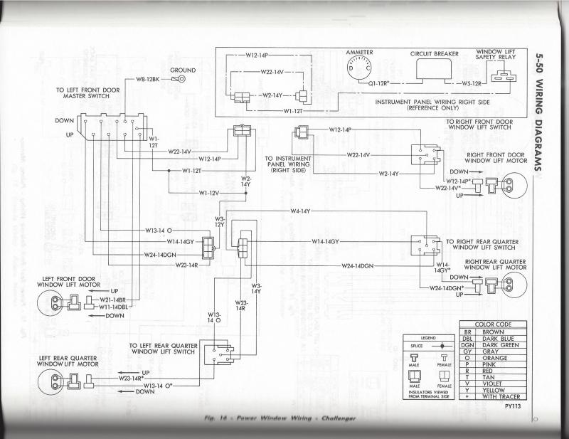

Looking for instrument panel wiring harness for power windows 1968 satellite sport convertible.
I don'y know anyone making reproduction power window harnesses, but the dash part is pretty simple, just a circuit breaker that connects to the ammeter, then goes to a key activated relay, and then to the body part of the power window harness.
Ok I have three wires coming out of the body harness do you hock all three together? Thanks for the relay part I can do that..
What color wires? Is this in the drivers side kick panel? I have a schematic around here if I can find it.
This is from my '71 FSM, but it looks about the same as the '69 Coronets. I think my '69 FSM is at my friends shop.
Frist thanks for the diagram. The color of the wires are two yellow and one brown and a black grd.
Thanks for the down load info.
I made a mistake on the colors of the three wires .The colors are two yellow one tan.
