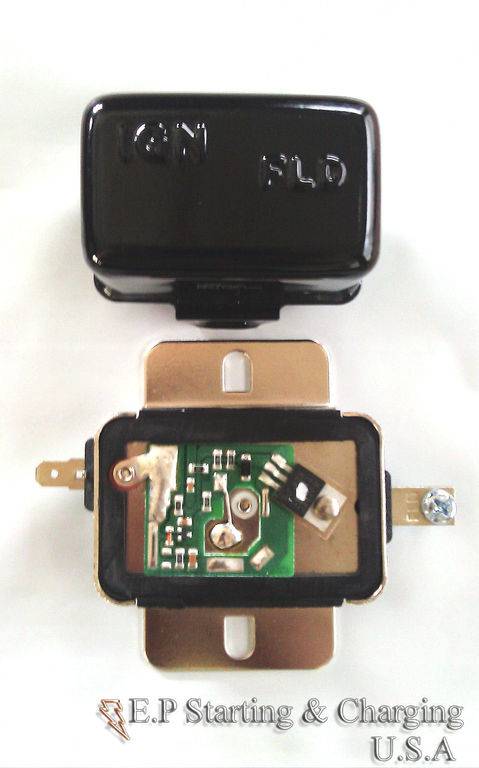

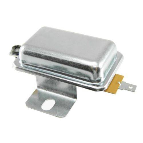

As for the voltage regulator, I don't really need to pay for date code. But I have noticed the regulators that have the "IGN" and "FLD" embossed on the cover as well as a nickel plated looking base appears to be close to a factory appearance. None of the images of the Voltage Regulators I see at Rock Auto are like this. They don't have any embossing on the cover and the base looks like a zinc sort of finish. I haven't looked at the ones at my local auto parts stores. I have NAPA, O'Riley's and Auto Zone.

And, I'm still kind of curious if anyone has tried the electronic or had any luck with the election versions like this one for $17.95 on eBay:

I am using one of the solid state electronic boxes you show above on my 1962 Ply and on my 1969 Ply with factory alternators. I am using them in conjunction with a Pertronix electronic ignition module tucked into the stock distributor plus Flamethrower coils. Zero issues with charging and except for one extra wire from the distributor to coil it looks stock.
I'm running Stock 67 charging system on GTX. A Mechanical
voltage regulator, stock alternator. It's not hard to adjust the air gap on VR if you needed. These system still work well if you maintain them. Good grounds are very important.
