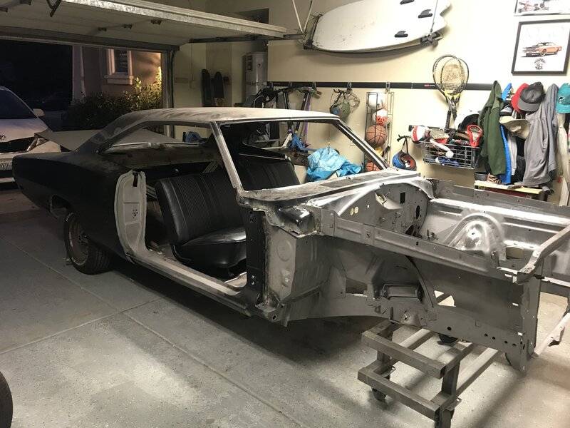

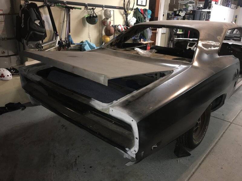

Plan is to get the main body in primer on Sunday. My question is: can I scuff over the black coating on the replacement panels and then prime right over them? Rest of the body is bare metal.

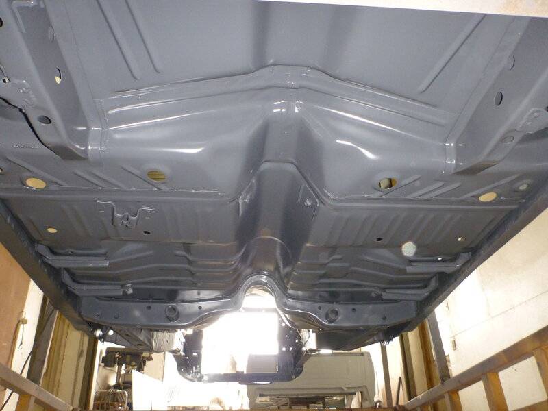

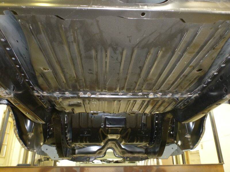

I'm not a body and paint man.. but ALL of mine was glass beaded off, epoxy primed and then body work performed to completion with a lot of hand sanding to boot.

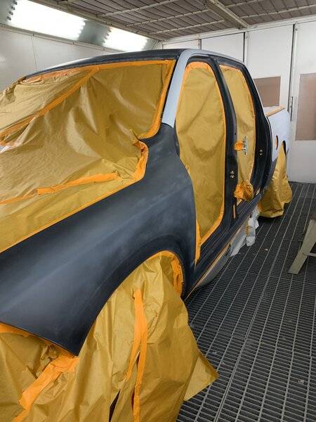

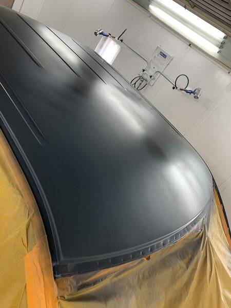

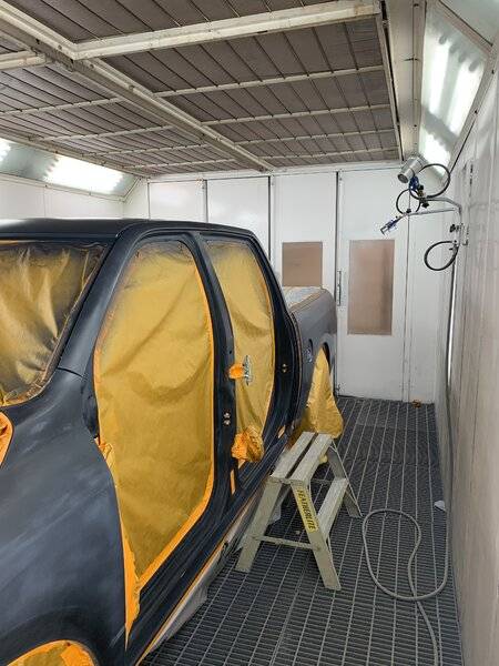

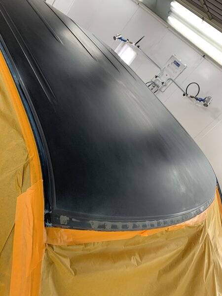

Heres a job Im working on now.
Feathered all the surrounding areas Where body work was done with 220grit Sanded the rest with 320. Then prime , block, re sand 320 knowing the body work is done right. Then 500 final sand and 800 the blend panels.
