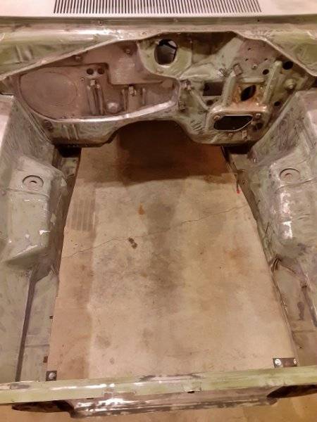

The engine bay - Someone sprayed flat black paint over the factory color. I think it is lacquer by the way it sands, I have sanded it off by hand but a fair amount remains in crevices etc. I had not planned on stripping the entire bay to bare metal, only where needed and then epoxy prime.

I hand sanded most of the flat black out of the engine bay, but there is some remnants.

I would say it is best to sand it down to bare metal, especially all of the body. Then you will be sure that that expensive paint job will stick. You can always do less under the hood and behind the grille, trunk etc... Paint jobs are too expensive now days to try to not know what is under there, and it is hard to only take off the top layer of primer. Get a cheap hand held electric sander and some 80 grit discs. Sand it in sections and put on the epoxy primer as you go so it doesn't surface rust. Depending on what kind of car it is, it should all be worth it in the end.
