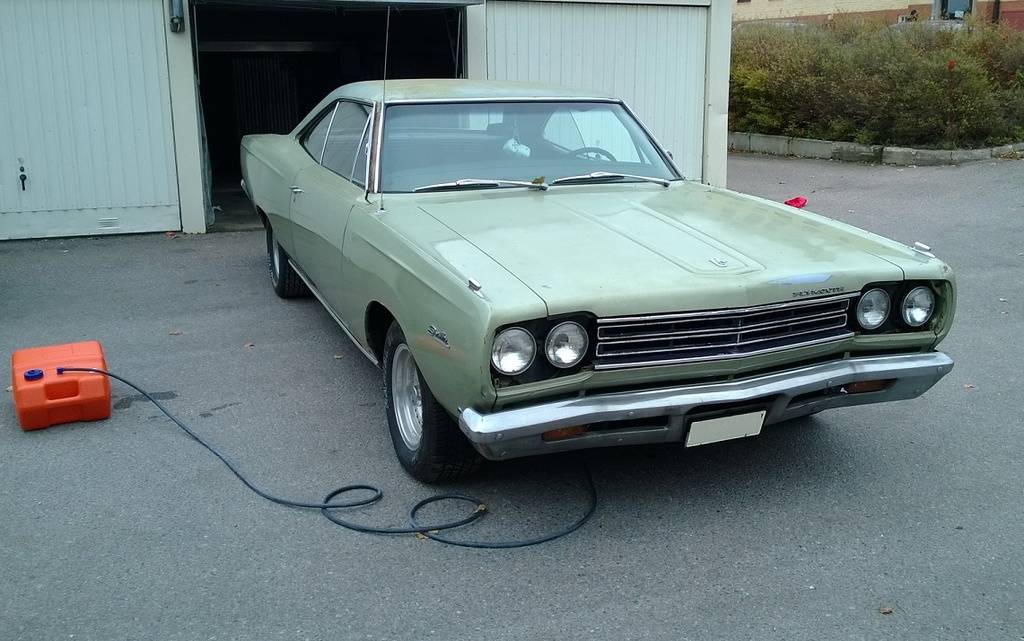

My Satty is going into hiberation too - first snow is just hours away, it seems... going to remove the battery and but a couple of dehumidifiers in the car - one in the back seat, oher in the trunk. My garage is not heated and has a tin roof, so there will be temperature changes, and subsequent condensation. Fuel tank is nearly empty, apart from the Californian soil and pine needles in it... will leave it in for now and replace the tank after I've replaced the trunk floor this coming spring.
My Satellite's winter dwelling. Fuel tank is full of dirt - I've ruined a few filters and a fuel pump - so car's getting clean fuel from a jury-rigged device consisting of boat tank and some fuel hose..
