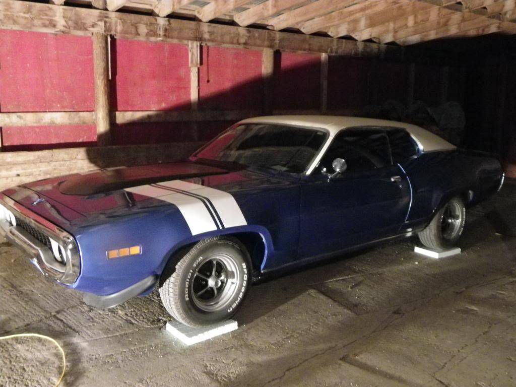

I assume Plymouth71 and I are in the same boat where we don't store the cars for the winter at home so there isn't access through the winter to do occasional starts and they damn sure aren't driving anywhere lol...
What's the purpose of the sunvisors down?
My car sleeps in a barn that about a 5 minute drive from my house that the owner has converted to do large barn dances and throw big parties with his band. It's a pretty cool set up for the winter I just have to time when I get my car in because he stores so many different things that sometimes I have to wait out other peoples campers or boats to access my car in the spring.
Rodents have been known to nest between the sun visor and headliner--eventually eating the visor, headliner, or both.
I pull the battery, swap the plugs for some Lucas Upper Cylinder oil, pour some Sta-Bil in the tank, put a plastic bag over the air cleaner, some Sta-Dri pellets in a couple of buckets to keep the interior dry, then put the car up on wheel dollies, cover it, and push it flat against the wall so my wife can have the garage back for her car over the winter. :crybaby2:
Well, not finished, It's parked on thick Styrofoam, Stabil has been added, battery removed and bounce sheets placed strategically. I still want to use the fogging oil and removed the carb for a rebuild, but I might be moving the car to a better location and so until that is decided I will leave it in. Picked up the Mopar Muscle issue, some good ideas. I will be installing a tennis ball in the exhaust.
I like the styrofoam deal. That will give the mice something to chew on rather than seats or headliner! OR just give them more building material for nests.

I've got her parked on Styrofoam, I'm going to go out and change out the coolant. The strength is only good to -29c which is not good enough for our cold winters. I'm also hoping to add the fogging oil too. Once thats done, I'm removing the carb to rebuild it. Just wondering if I should wait to fog after I rebuild the carb and get it set up first or... what do you think?
Fog and then remove the carb. Then you have all winter to rebuild, right?

I was great, It started on 1st crank ! Like Instantly. I forgot to take the tennis ball out of the exhaust and it shot out like a cannon LoL. I had quite a bit of leakage from the trans dipstick, but I was told this is normal for sitting so long? It wasn't a huge issue though, I topped it up and all was good.
