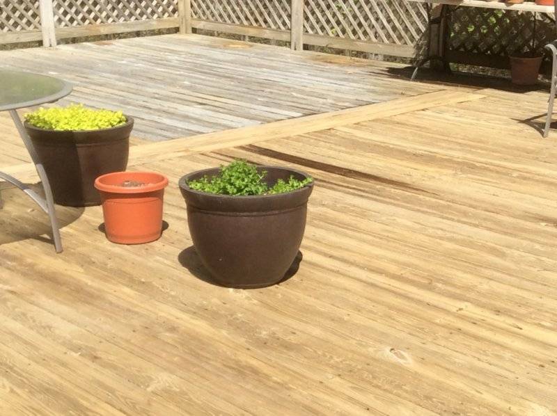

Depends on how large an area and what your cleaning. More gallons ger minute faster the cleaning. Vinyl siding you don't need a killer 4 gpm stairs to remove loose paint 3 gpm should do it. Rent one and see how it works. I rented for 2 years but doing my 1100 sqft deck in a day and half to much. Hand went numb for 3 months, couldn't button my shirt right handed. Bought a 13 hp 4 gpm 3500 lb washer. Make sure you can fill a 5 gal pale in 1 minute if you buy a 4 gpm washer. Clean foreground grey beyond.

That’s a heavy duty power washer. Most gas versions I see seem to be in the 2-3 gpm range with smaller engines.
