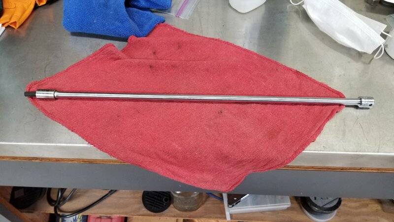

One additional question: I don't have a 5/16 hex priming rod. Do you think I can use the setup below? It is a long 3/8 inch extension with a 5/16 socket on it. I can also add some electricians tape to help keep the socket on.
Thoughts?
If that socket goes threw bushing don't lose it coming out. I cut an hex wrench cut the diameter down on a 1/2" of it to fit inside straight 3/8" steel tube and a steel shaft on other end and brazed it together. No welder the time.
Not likely that will fit through the bushing. I used 2 stock shafts, cut the gears off each, welded them together so hex on each end & they fit the bushing like stock. The ones available from Summit are quicker & easier than making my own.
I've seen paint stirrers for a drill with the correct shaft size. You could just cut the shaft off

I bought a 3-ft length of this(5/16") and cut it to fit so my drill sits exactly where I want it to..the 1-ft piece isn't quit long enough. Plus I'm a cheap bastard.
https://www.mcmaster.com/hex-shafts/low-carbon-steel-hex-bars/

You are correct! I tried it last night and it will not fit. A priming rod is $13, so I just ordered one - smart to have a proper tool anyway.

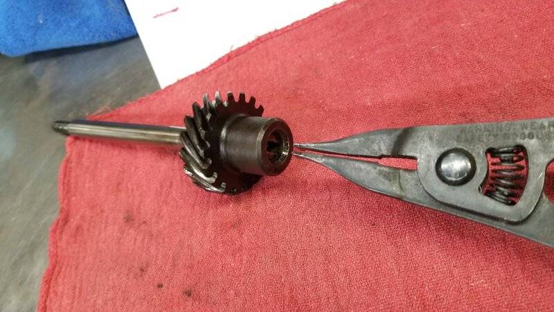

Also, I messed around with my original engine last night. I found that reverse pliers are perfect for pulling the shaft!
I use the large external snap ring expander pliers most of the time on mine.
