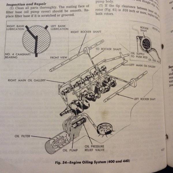

Hi satellite man,
I am attaching a diagram of the engine so you can understand that the engine and cam have to be in a certain position for the oil to be pumped throughout the entire engine. Going to the left bank as well as going to the right bank. The crankshaft has to be turned so the cam can switch the offices of the oil passages so that the oil can actually be pumped to the top of the engine. It will fill the rocker arms with oil as well as come out of the rocker tops where you can see the oil. If you do not see oil coming from the rocker area the engine is only partially primed and that is why you feel so much resistance when you are turning the oil pump.
I to ran into this very issue when I was priming an engine as well. Further investigation I found this diagram in my maintenance book for the year of my car. I then did exactly what it said to do and I achieved oil coming out of the rocker arms. Once you have oil coming out of one side you have to then turn the crank farther to exchange passages to prime the other side of the engine.
I hope this helps you to understand and achieve your priming.

Hi satellite man,
