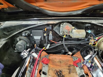

Current Pro-Flo4 install.
Yep. Speedo, oil pressure, fuel, sort of work.
