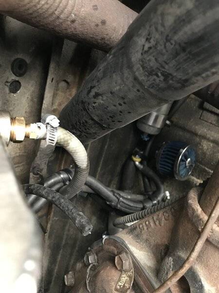

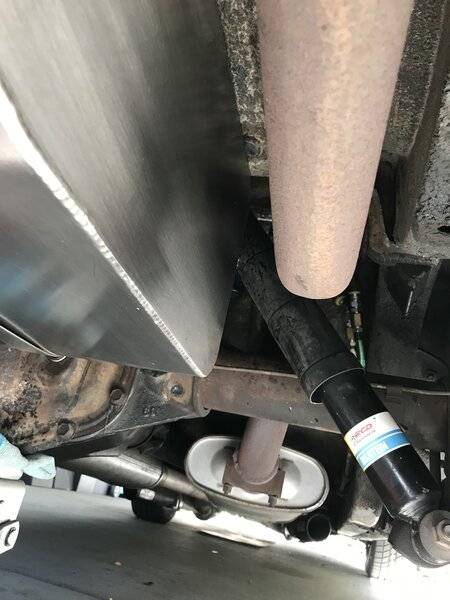

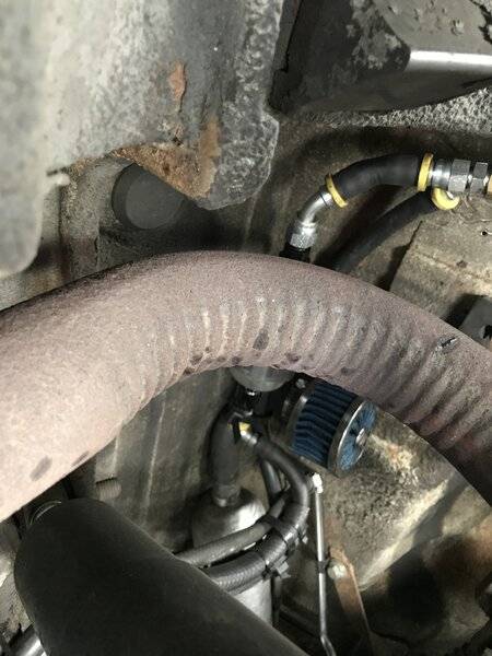

View attachment 1037841 View attachment 1037842 View attachment 1037843 Sorry about the camera angles. Just wanted to show the elaborate clusterfluck required to stop the tank/vent from pissing fuel at fill up. Fugure this out before you get any efi. Again, everything AHEAD of the firewall was plug and play. It’s the plumbing from there back. With breakdowns, cost of tank and lines could easily tack 8-10k on the cost.

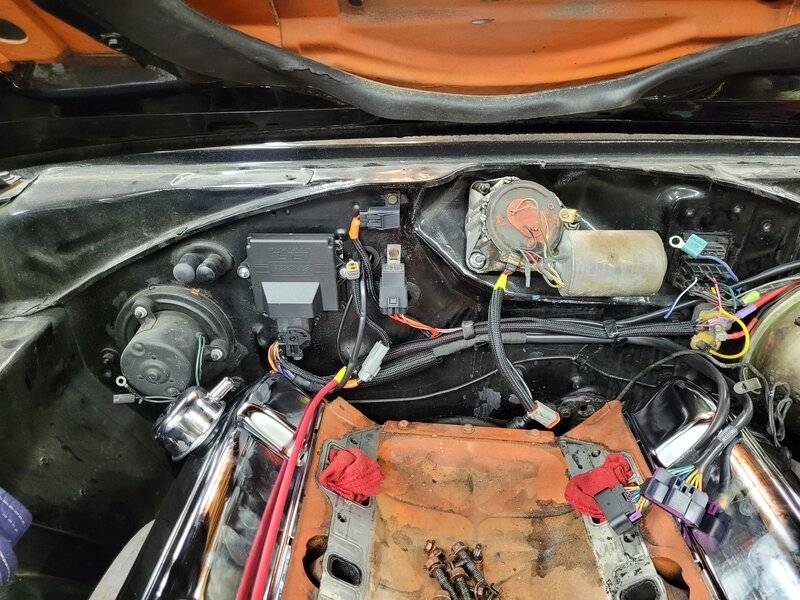

Current Pro-Flo4 install.
Yep. Speedo, oil pressure, fuel, sort of work.
