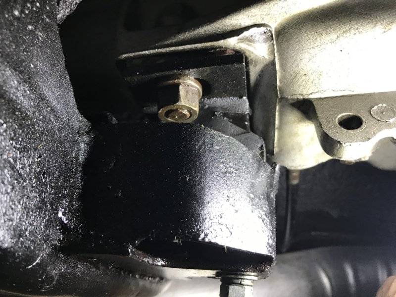

It’s not the converter bolts. They are good. Only does it in drive when moving. Not coasting in neutral either. Here’s a pic of the rubber tranny mount. Would that cause it like mentioned? It looks like it tore along the top and see splitting on bottom

That’s the way those look. Only to know for sure would be to take it out. They are cheap, so wouldn’t be much to replace it.
Do you think that’s what’s causing it to make the noise?
Usually in reverse it makes noise. In a safe place with some room, push hard brake with trans in reverse give it a LITTLE ( enough so it's straining against brakes) gas and let up on the GAS if you hear a clunk where rear trans mount is, think you found it.
