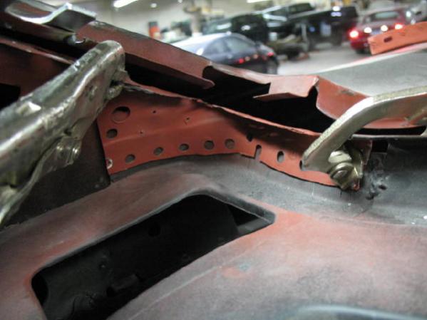

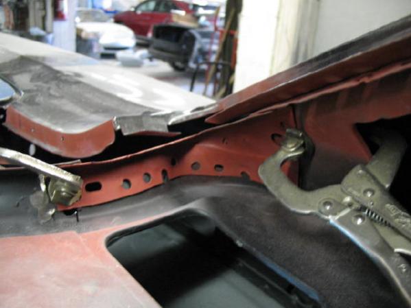

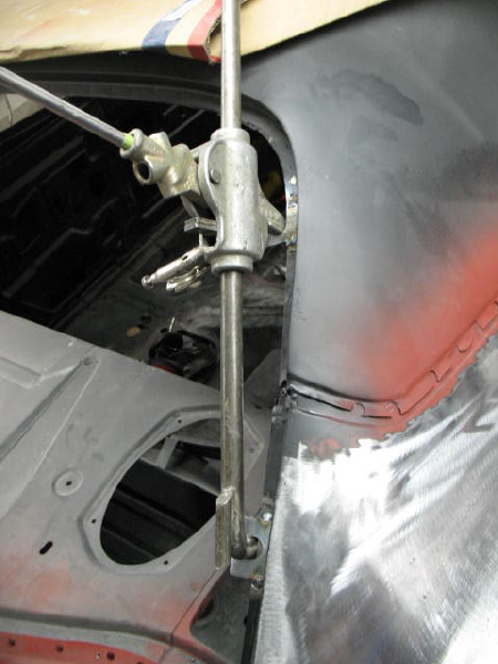

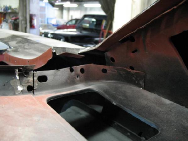

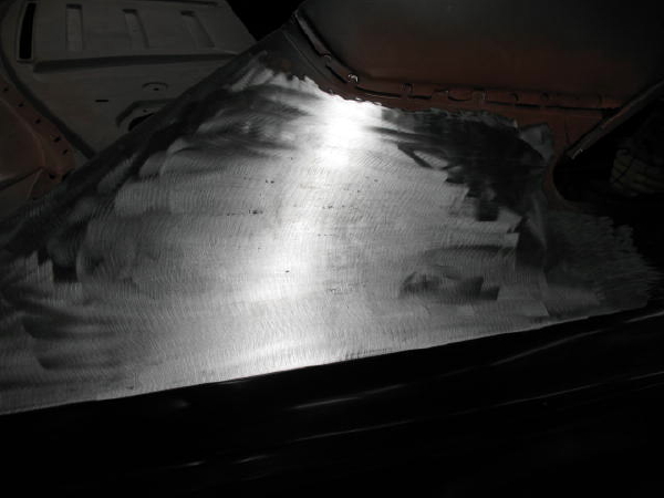

Once I was happy with that fix it was on to the next because this quarter was all tweaked out of shape. I needed to shrink the back window opening by a half an inch to match the Drivers side. Restoring a car in your buddies collision shop does come with some advantages, like not having to Macgyver some crazy body jack together out of carpenters clamps and tools as I would have had to do if I were still working on the "DOG" in my shop. (Allthough I do enjoy the Macgyver method equally) Once it was squeezed together where it should be I tacked it in place in the window channel to hold it and doublechecked the c-pillar transition that I had just beat into shape with the template and found that it required another beating. Next step is to weld the deck filler panel to the package tray along with all of the little parts that stack up to form the lower rear window corners. The first pic is what the c-pillar looked like after the beat down, it is amazing how hard you can hit these parts without absolutely destroying them!

Wow.... Crazy amount of fit up work on those quarters Matt
Yeah I know, just my luck to get stuck with some one off mutant prototypes! Remember that I bought these things over 3 years ago, I'm thinking prior to AMD working out some of the bugs on these full quarters.

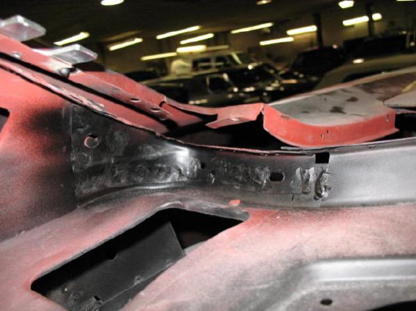

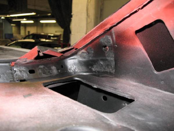

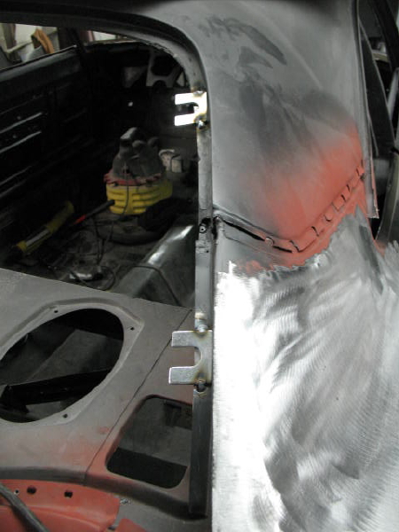

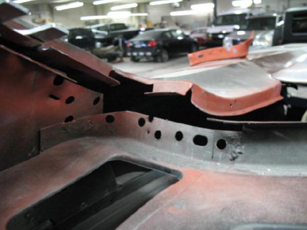

Time for my weekly update! Started assembling the lower rear window corners. Pictures should tell the story on these. Installed both sides. I don't think these are being repopped yet and I was lucky enough to salvage these from a past doner car. Next week I will put the smaller AMD pieces that fit between these and the window channel of the full quarter and hopefully the filler panel.
