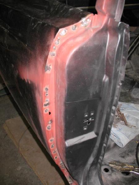

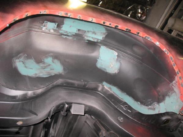

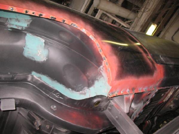

Started to weld the passenger side quarter on for good!

Thanks guys for checking in on me. Lots of welding and grinding on these quarters but nothing that makes for any pictures you haven't allready seen before. Quarters are about 75% installed, still have the c-pillar, deck filler area to weld and then I will move on to the trunk gutters, tail light buckets and the panel that goes between the tail light buckets. After that I will move back to the front for the radiator core support and the final fit on the fenders and hood.

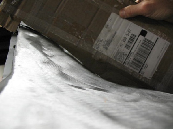

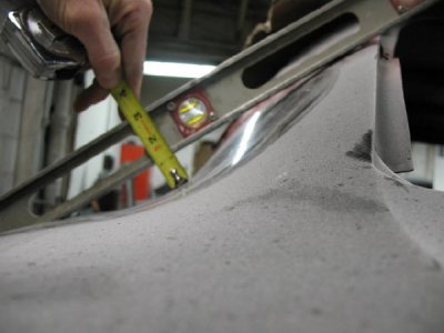

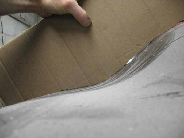

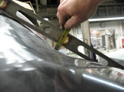

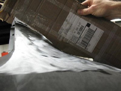

Wish I would have done this before I had welded so much of the quarters on because it probably would have ben easier to deal with but it is what it is. I knew I had an issue in this area but I didn't know to to what extent. This is what I am up against now. I made a cardboard template of the drivers side because it looked right to me where as the passenger side didn't.

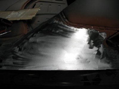

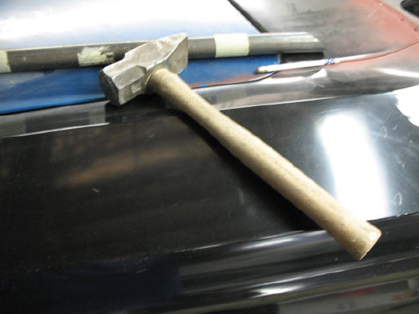

First thing I did was strip the e-coat off so as not to hammer it into the panel as I beat it into shape. Grabbed a steel pipe and a big hammer and went to town on it! Good results.
