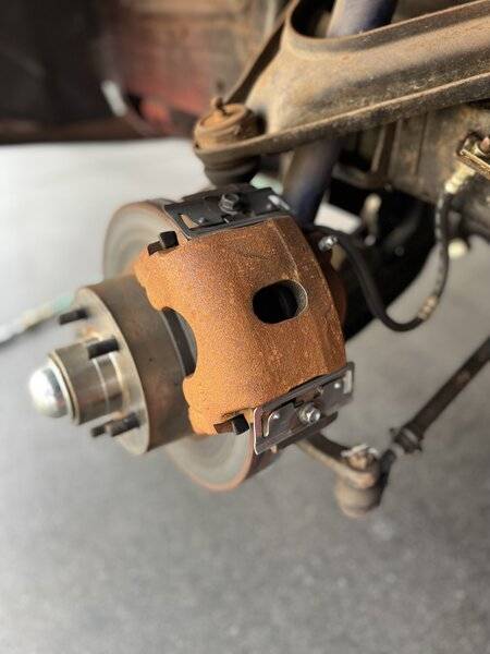

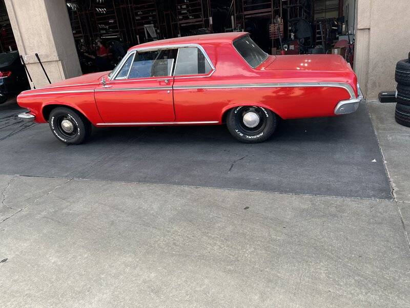

Got new shoes for the old girl. 225/70/15 and 275/60/15 Cooper Cobras. The fronts barely rub only at full lock. Also got to check out the front disc conversion the PO did. Suppose to be off a 70 Challenger. Not sure. I did letters out for some flash.

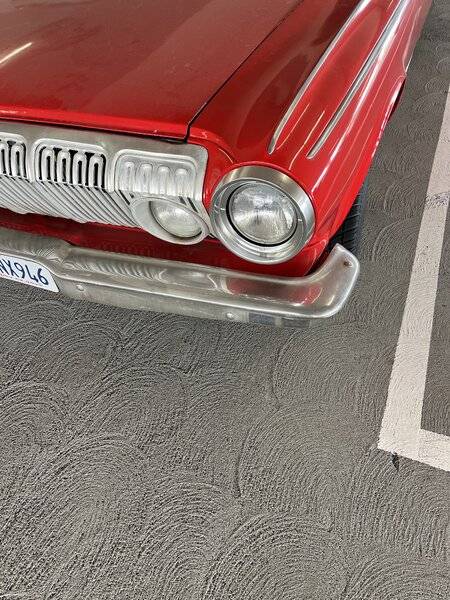

Got my new headlight trim rings on. New reman’s he has 1 set left.

Those look like '73 up brakes - better IMO. Easier to get parts for, they used that style up into the mid eighties.

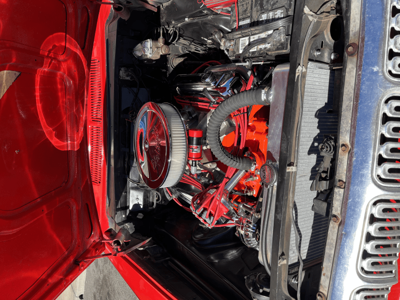

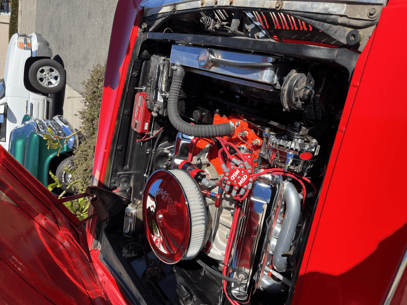

Motor work is done. Ended up with a Isky 292 Mega cam, 440 source CNC heads, Dougs D452 headers, new 2.5 inch exhaust with Magnaflows, and a full MSD ignition. It runs sweet now.

back again. Still have pneumonia in both lungs. 10 weeks on lock down. The cars a stinking beast. 36 degrees total no ping. first gear is useless if you open the secondaries under 30to 40 mph. Cam and heads fixed my detonation problem. Went from 88ccs to 80ccs. 9.5 to 10.2. 270 comp. Cam to an Isky 292 mega and no posi. Overall I’m happy with my changes. Electrical is next then window trim after that is rust. Then it sets some bars.
