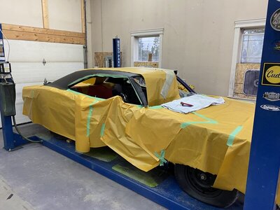

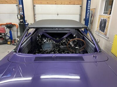

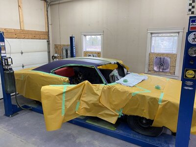

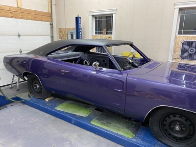

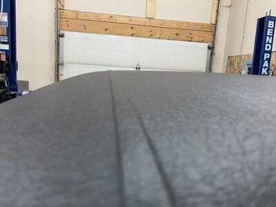

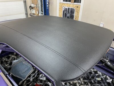

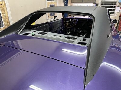

Got it on!!! Really happy with the end result. Thank you to a local good friend for the extra hand. Time to start polishing and mounting the trim.
660AA442-817E-4967-B3AA-AF87E749EEC0.jpeg CC330486-D485-4A7D-9D59-EC75EBAF8922.jpeg 61C7FA55-959B-4C41-B520-D399637B0495.jpeg 750CA46F-ED7C-4A06-99E5-2A0B7834B332.jpeg F6A914FA-7378-4033-ACA7-D214BE97A881.jpeg FC0A78DA-BD3F-4931-9DA6-DBCB1B872822.jpeg DCFAAD2F-4E64-42D2-9F3D-48E9BA49BF27.jpeg
Forgot to mention that this is the adhesive I used, was very happy with it - extremely strong bond. Just helping out the next person!
So was the roof the same FC7 as the rest of the car and you just scuffed it before you applied the glue?
You did a great job on the roof vinyl. Did my head liner by myself and will say it can be done just like vinyl top. I will say that my hand's and finger's hurt like hell the next day. Good job!!!!! Blue.
